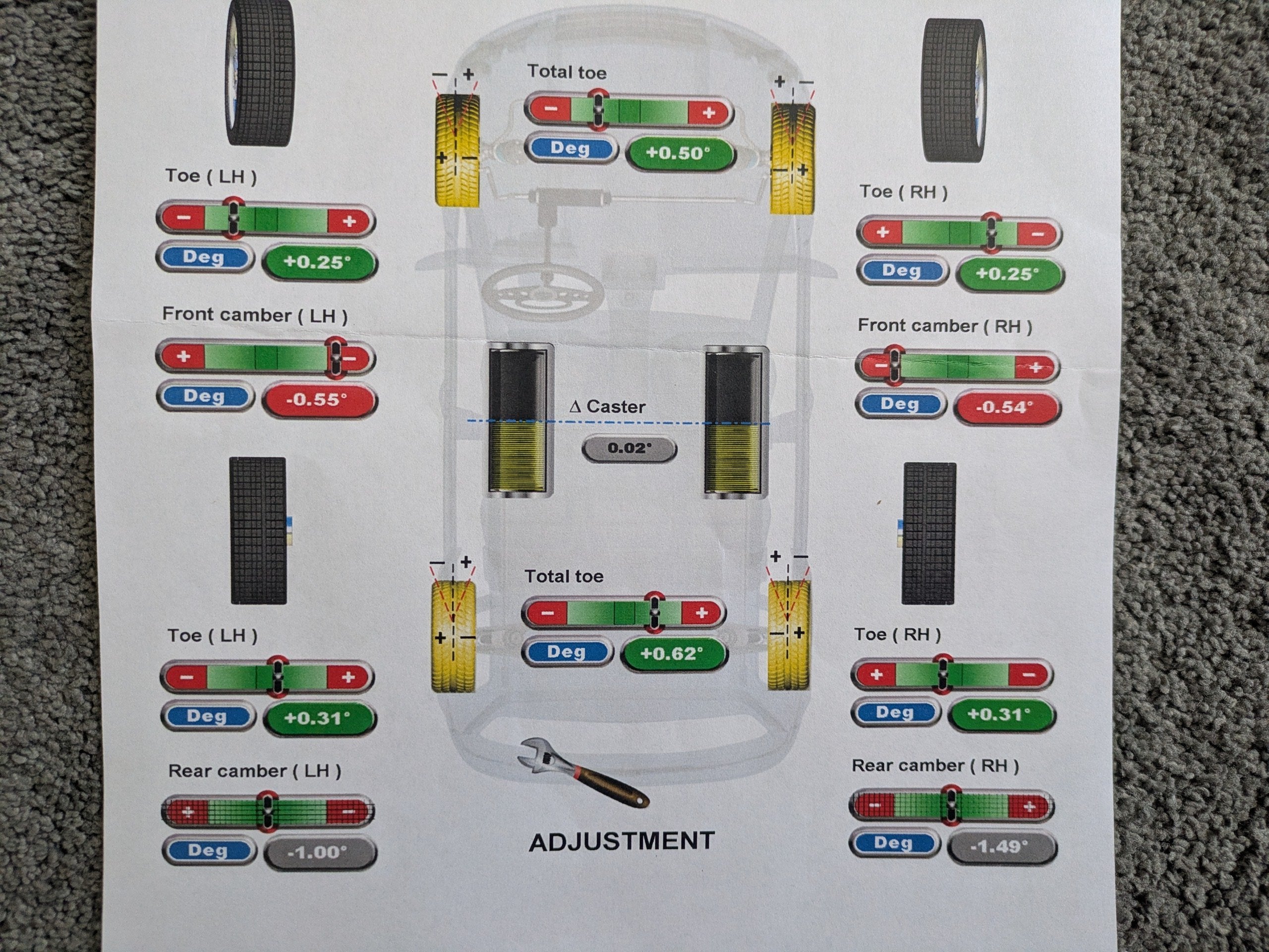

A few updates. Got the new tires installed, road force balanced, and a wheel alignment. Now the car pulls slightly to the right 🤷‍♂️. Will take it again somewhere else for alignment, see what they say. What I can see is that the rear right camber is -1.49, which is a bit out of range. Maybe there's some suspension issue that's not visible with the naked eye.
Now the vibration is less visible around 40-60mph, but still there. The wheel is not shaking crazy anymore, which is good.
