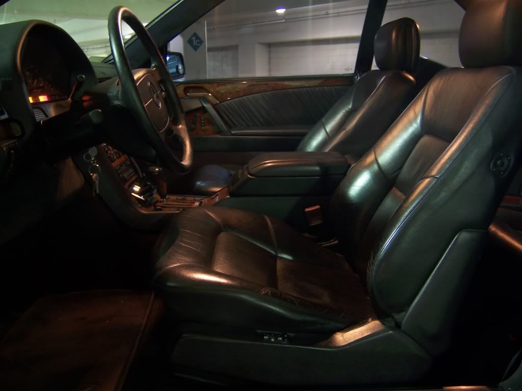

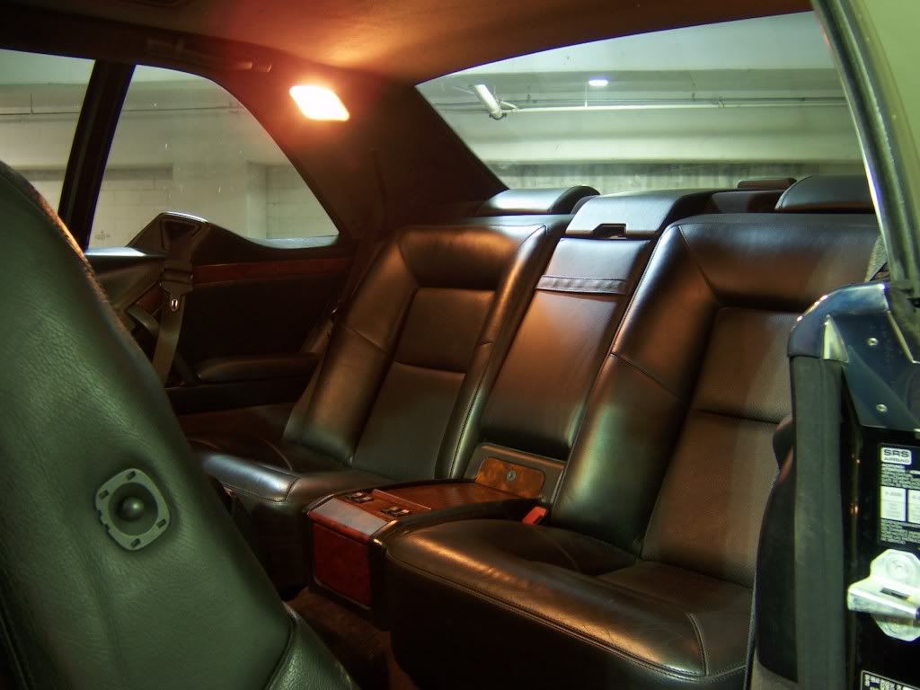

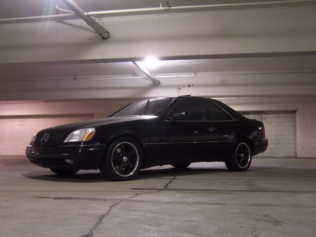

Hey All,
Just picked up a 94 S600 coupe for relatively cheap. It's a little rough, and perhaps I should have looked for one in better shape, but the price was right so I went for it. It's black on black with 90k.
I have searched around on here and I know how frustrating it is when newbs ask questions that the regulars think are obvious, but if you could point me in the right direction or give me a link to some helpful threads that would be great.
Issues:
-Fan blows strong, but air is not cold.
-Orthopedic seats will inflate, but deflate quickly after and won't inflate again.
-Rear windows won't even attempt to move down. Haven't checked fuses yet, but are there relays or junctions I should check also?
-Power antenna doesn't work, is it interchangeable with the sedan or different?
-Driver window doesn't seem to index properly and leaves a small gap which makes for some annoying wind noise. How to reset indexing?
-Idle is a little rough, going to try unplugging MAFs tomorrow to see if that helps it at idle. Are these hotwire type MAFs? Any other common issues?
-ADS is stuck in sport mode I believe, ride is a little rough but not as bad as some. Hydraulic fluid is also low. *IF* I replace the accumulators, will that fix the sport mode issue and get rid of the light on the dash?
So that's a hell of a list, but that's the majority of the issues. Any help is appreciated. Here are a few obligatory pics, the wheels are going ASAP and the car is going to be detailed and the hood repainted soon. Excuse the dirtiness.

Your car actually looks ok, at least in the photos. A few cosmetic things, and the mechanical items you list are all fixable.

Congrats on the car, and good luck with it. I have to say, I don't dislike the black centered wheels with polished lips. The silver hub cover needs to be black, but the look isn't that bad, given the dark tint as well. Can't tell what wheels they are, but if they're cheapos, probably good idea to replace them.

I'm looking at picking up some genuine AMGs to replace them. Personally I think the all blacked out look on cars is pretty played out. If it were me I wouldn't have tinted the windows nearly as much, and I want some nice painted silver wheels.
