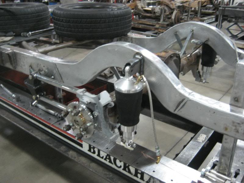

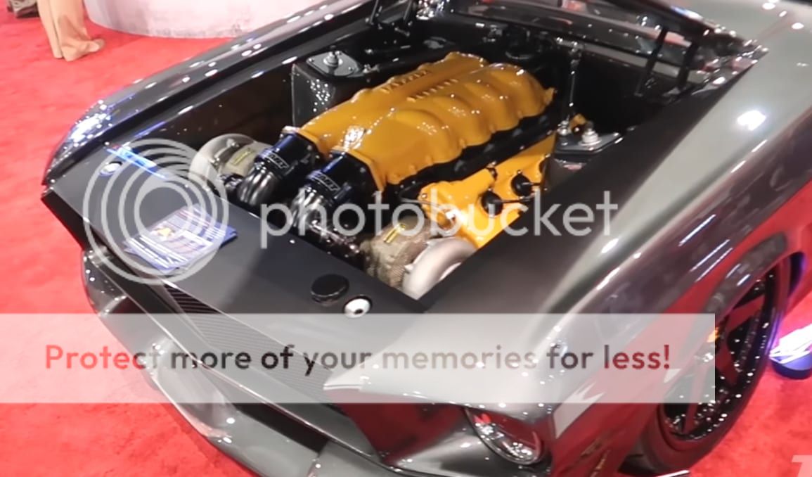

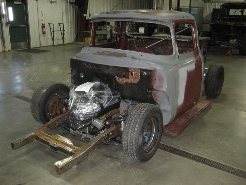

I know you’ll chime in to get that post count up so I’ll add a few more photos for effect. The first are some photos while at WCC.
http://i61.photobucket.com/albums/h72/roodogg/wcc dvd/206.jpg
http://i61.photobucket.com/albums/h72/roodogg/wcc dvd/185.jpg
http://i61.photobucket.com/albums/h72/roodogg/wcc dvd/197.jpg

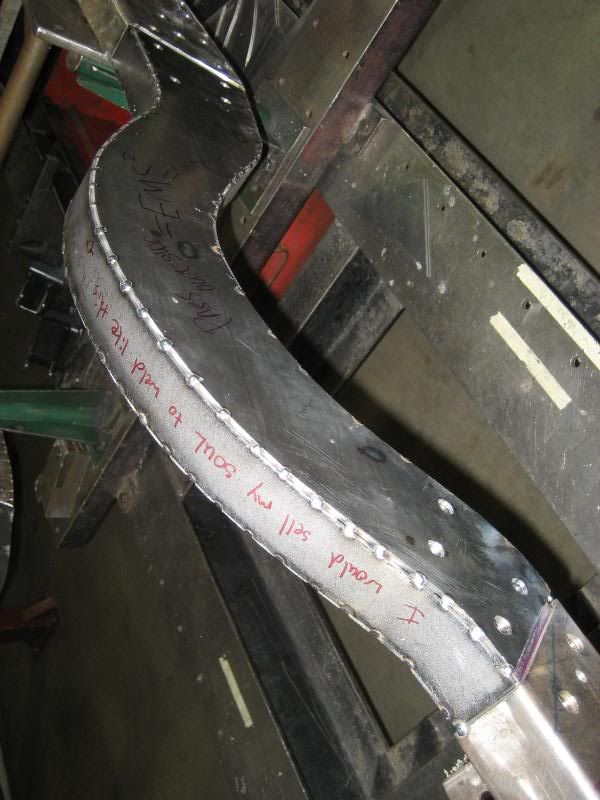

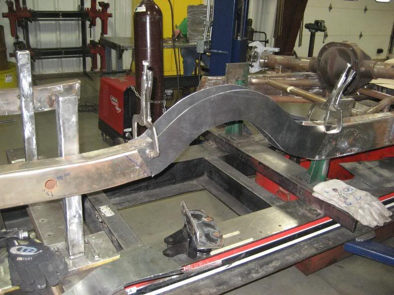

My own back half of my old pickup where I cut out the old step notch and built sweeping rails from flat stock. And added air.....ya know.....cuz it wasn’t designed to have it.
http://i61.photobucket.com/albums/h72/roodogg/more f100/IMG_1161.jpg
http://i61.photobucket.com/albums/h72/roodogg/more f100/IMG_1301.jpg
http://i61.photobucket.com/albums/h72/roodogg/more f100/IMG_1328.jpg
http://i61.photobucket.com/albums/h72/roodogg/more f100/IMG_1342.jpg
