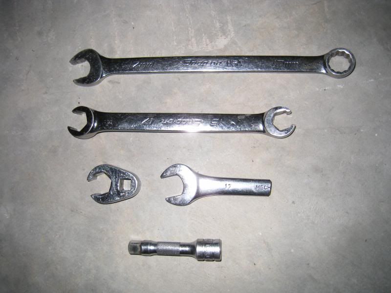

I had a tool that made removal a breeze. I consider this tool necessary to remove the valve block assembly. I see no way to remove the assembly safely without it:
Snap-On 17mm Crows Foot: FRHM17
A similar crows foot may work but, this is the exact tool I used and removal was a snap. If you don't have one, you can call or stop by any service shop and ask any tech for the number of the local snap-on distributor. Alternatively, a parts store or Craftsman crows foot may work.
Here are the primary tools I used for removal:
All ABC Hose Fittings requiring removal to remove the Valve Block are 17mm.
The short 17mm wrench is a wrench I cut down long ago. This helped in removing one of the ABC Hoses but, I don't consider it crucial to the job. As with any hydraulic hose you MUST use a wrench designed specifically for removing hydraulic lines. Failure to do so will likely result in a rounded off ABC Hose Fitting and possibly necessitate replacement of the entire ABC Hose! The standard wrenches above were used for ease in loosening and removing the ABC hoses only after they were initially broke free using one of the Line Wrenches.

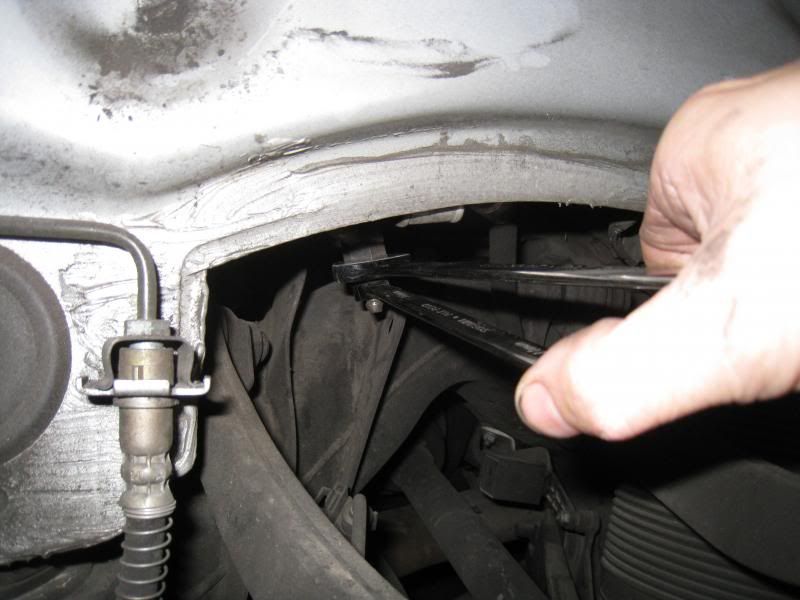

First, all 4 corners of the car were up on jack stands. While the Valve Block Removal procedure could be carried out with just the rear of the car up on stands I will be working on the front Accumulator as well so, the car was in the air. I mention this as having all 4 wheels at full droop completely depressurizes the ABC system (after about 15 minutes in the air).
To be safe, I also loosened the rear left ABC valve:
I loosened this fitting slowly and there was some pressure released along with minor fluid loss. Place a drain pan under the fitting and Loosen slowly!

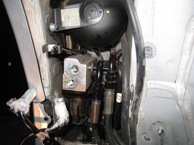

Move the drain pan below the Valve Block Assembly. Clean the entire area (any dirty hoses, Valve Block and Accumulators) with Brake Clean then blow off with compressed air. Air in a can is fine if you don't have a compressor handy. Wipe down any excess with a clean rag.
First, remove the 10mm nut securing the hose retainer. This will allow for extra movement in the hoses while disassembling.

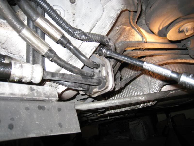

Remove the first hose:
As you can see the Crows Foot is a perfect fit for hose removal. Break the hose free then use the crows foot or your fingers to remove.
As soon as the hose was removed from the Valve Block I cleaned the fluid off with brake clean on a rag, then wrapped the hose end with saran wrap and tape to insure no dirt enters the hose. If you are not planning to disassemble and clean your Valve Block install a plug in the port immediately to keep dirt out.

Again, wrap with Saran Wrap and tape/block the hose end and also the port in the junction block if not planning to clean it.
And the next one:

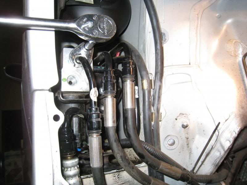

And now moving to the 1st hose on top of the Valve Block:
It's a little tight removing this hose once the fitting is removed from the Valve Block. Clearance is at a minimum between the Valve Block and the Accumulator. I found the hose much easier to safely maneuver when grasped from below with one hand then the top of the hose maneuvered out and away with your other hand:
Once that hose is safely removed proceed to remove the rear hose:
Here I had already broke the fitting loose with the line wrench and was proceeding to loosed the fitting with the stubby 17mm. If I did it again I would remove the top nut securing the entire assembly to the car (via the rubber insulator, just above the large accumulator) and carefully try to slide the entire assembly out a little bit and get a hand in there to loosen the fitting by hand. It was a real pain loosening the fitting even with the short wrench. There's just not a lot of room in there. With all the other ABC hoses removed at this point it's likely you can slide the entire assembly part way out.

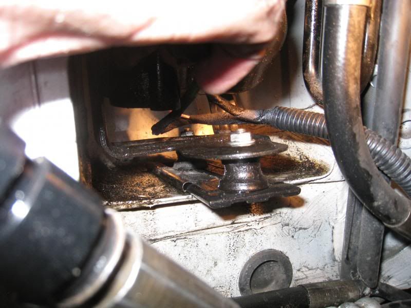

I mention above the entire assembly slides out on the bottom. Here is a good pic showing the slide mount:
Once you have removed the top rear hose in the step above you are ready to very carefully slide the entire assembly out of it's cubby. Be sure to clear the way of the ABC hoses you have removed and you don't pull on any wires connected to the Valve Block. Slide the Assembly just enough to reach each electrical connector to disconnect.

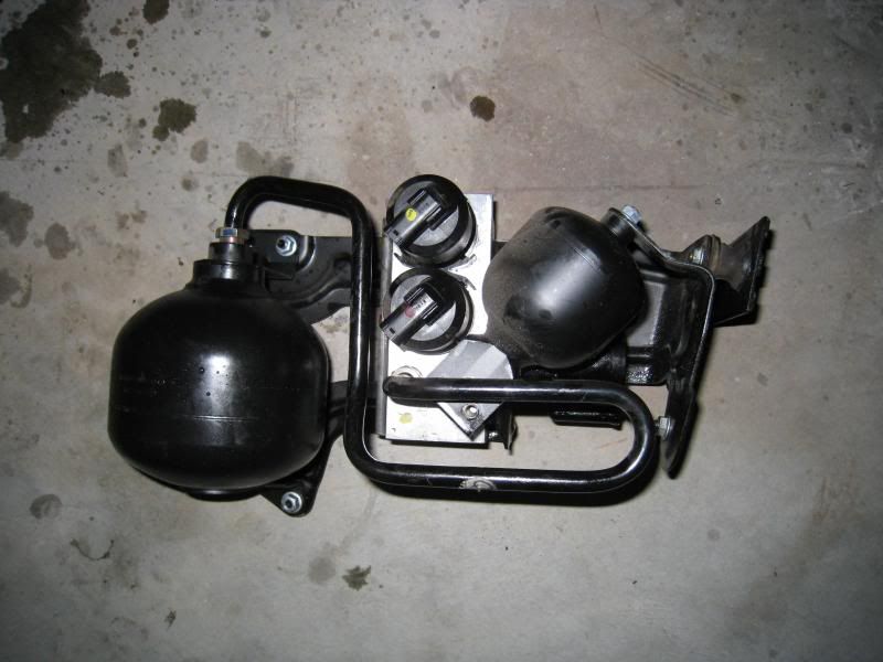

Here is the assembly removed:
Finally, the entire assembly removed from the car:

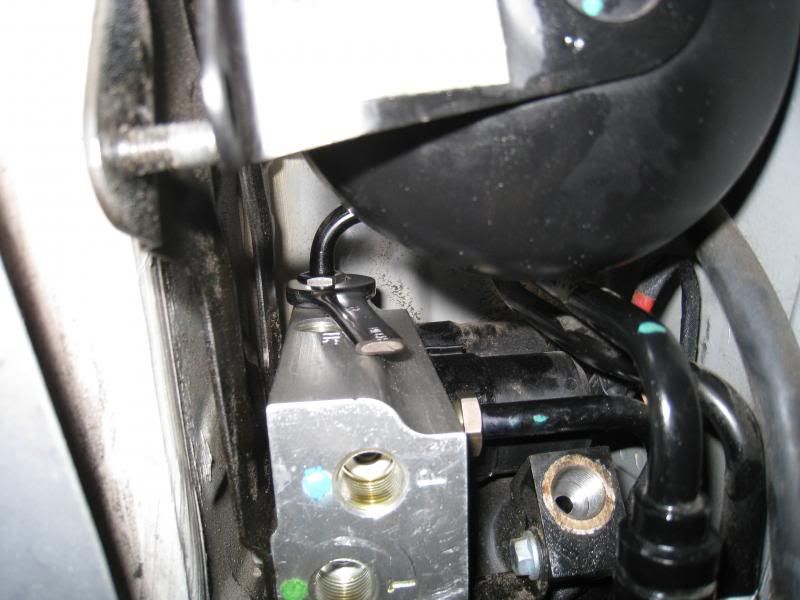

Hi Brian, here is a picture of one of the bleeder valves I referred to earlier. I apologize for any confusion I referred to it as a shrader valve it is actually a bleeder valve located on each of the rear ABC hard lines which leads to the rear struts. With the rear wheels removed you will see them clearly and easily when looking into the rear wheel well. In this picture I have the two wrenches in place and ready to crack this bleeder loose to release pressure to the strut:
I see no reason to remove the fuses during this procedure
The procedure again:
1) crack the rear wheel lug nuts loose while the car is on the ground.
2) Jack up the rear of the car and remove both rear wheels. Place a couple of jack stands under the rear of the car.
3) You will see the bleeder as described and shown above in each wheel well. They may have a rubber boot over the end of the valve you will remove.
4) Wait about 15 minutes from the time you jacked the rear of the car up (this helps relieve some pressure at the rear struts) then place a container under the bleeder valve and SLOWLY crack the bleeders open to relieve the pressure in each rear strut using two wrenches - one to hold the bleeder body and the other to open the bleeder valve. You should loose very little ABC fluid but it will be under a fair bit of pressure.
5) Once the pressure has been relieved tighten the bleeders back up and bolt the rear wheels back on the car.
6) Place some wood under the rear wheels and slowly lower the car. As the rear struts have been completely relieved of pressure the rear of the car will sit very low. The rear wheels will be up in the wheel wells when the car is lowered. The wood under the tires insures the struts are fully compressed and the car does not bottom out on the jack.
