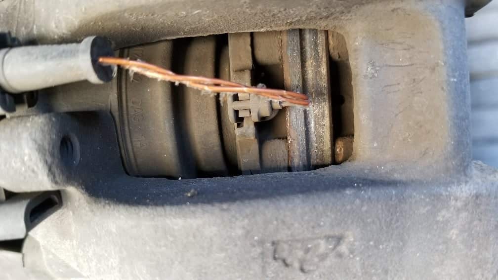

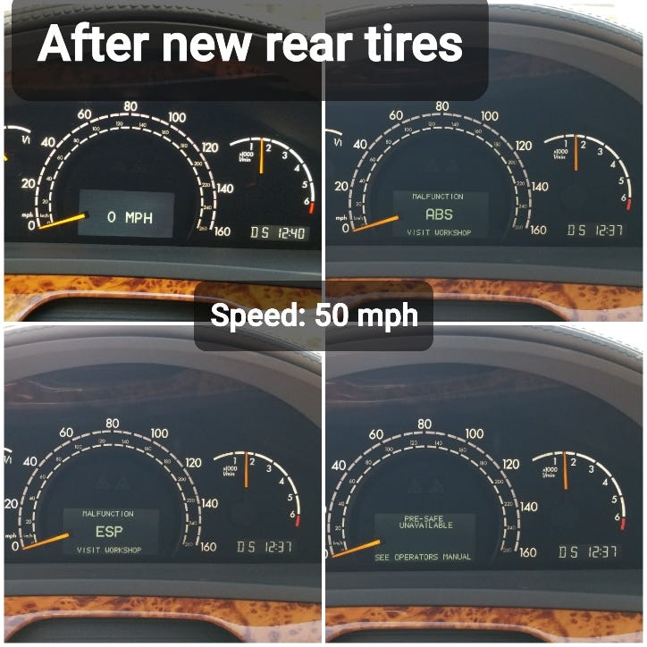

Just had new rear tires installed that are a different size than the previous: 275/35 ZR18 (1" wider, 1/2 shorter). Immediately after pulling out of the parking lot the ABS and ESP Malfunction notifications came on.
I'm about to plug in the SDS for a look and then put it up on jacks to check wiring.
Just thought I'd post this in case anyone had any immediate ideas or advice.
I took photos of the brake pads to check for wear while they had the rear wheels off.
Very likely the Rolling Circumferences no longer match due to wrong tyres ;)

Okay...yes, I intentionally have slightly taller tires on front P245/50 R18 for a better ride. They've been on about a year.
Previously had 265/45 R18 in back, but got tired of having ZERO protection from even the slightest curb scuff chewing into the rims! So I went with a slightly wider tire, but it also happens to be slightly shorter than the previous.
According to Tire Size Chart
Front: 245/50R18 = 27.6x9.6R18
Rear: 295/35R18 = 26.1x11.6R18
So you're telling me because I now have a front/rear tire height difference of 1.5", which results in a different rolling circumference, the computer cannot adjust it's processing to handle this?
Other than replacing tires, can I do something to mitigate this via SDS?
By the way, SDS says "Speed signal from control module ESP implausible" which supports what you've shared.
And I take it since the front/rear wheel speeds aren't congruent, the speedometer won't work at all?

Forget the german cars, even american cars will throw a shitstorm if the tire size are too different. Had a 2012 Camaro not too long ago, same story. Turns out owner didn't tell us that he installed staggered 26" rims prior to us checking it out.
The ABS/ESP is tied to the drivetrain and half of the suspension, so yes the car will complain if the tire sizes are too different.
Your tires have a difference of 11%, a massive difference from the allowed 3%, so yes the car thinks shits about to hit the fan.
