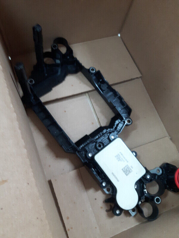

BenzDreams, Don't get too discouraged with the above posts. It will cost you money, but may not even be close to what was quoted above. It all depends on the issue. If it is an actual problem with the CVT, then it may be costly. But if it a problem with the TCU in the Valve Body of the Transmission, then it can be repaired. In majority of the transmission issues it has been the latter. MB refuses to repair this issue and usually errs on the side of replacing the valve body or entire transmission. This is where the huge bill comes from. If you find a mechanic who is experienced with removing and repairing this. This can be done at a fraction of the cost. Very few mechanics are versed in this repair. There is a guy in Bulgaria who can do it, and he has dropped many messages on this forum. If you get a reputable and knowledgable transmission or MB mechanic to pull the VB and mail it to Bulgaria, he will repair and mail it back for install. This will cost around $600 plus mechanic labour, and possibly delivery. That is of course, if this is your problem. It is an electrical problem that has affected a number of transmissions. Your first step is to find out what type of issue you have. Good Luck.
Company in Quebec that repairs the tcu and they have repaired units in stock -core charge is $300 fyi. Don't tamper with it or they will charge you a non-refundable core. I removed mine after watching a couple youtubers do it -ez -and took my tcu in to Bates Electronics in London, ON he resoldered the broken wires in mine cost me $150 cash fyi
