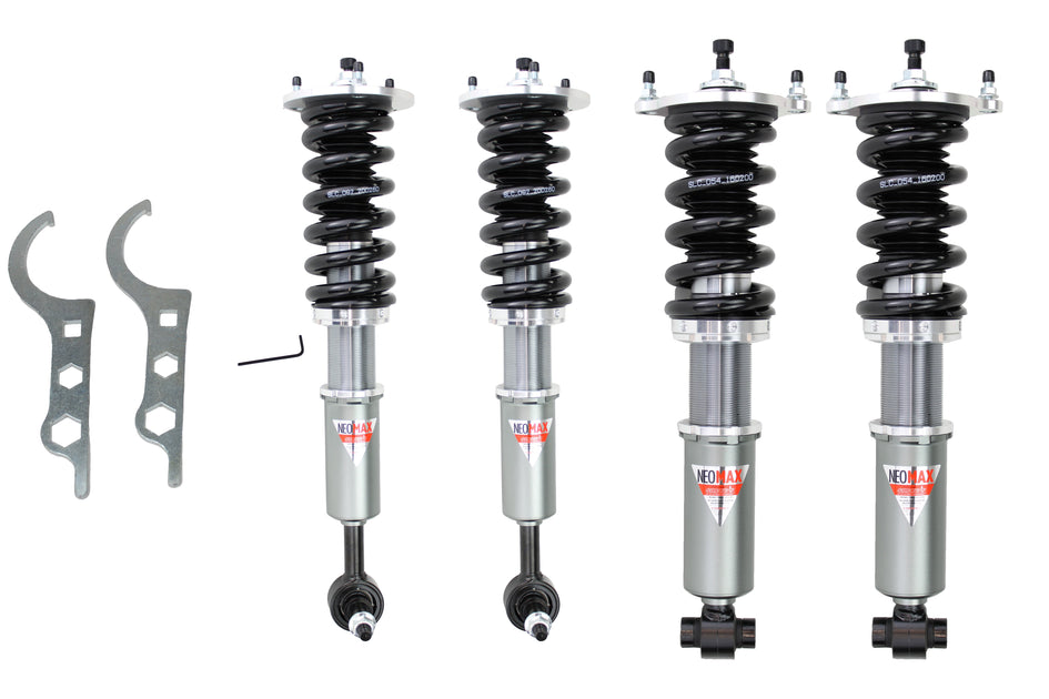

I am hearing Neomax is better. Any thoughts?

I've got Strutmasters, overall it's been good. They aren't adjustable and ride a little low in front. Someday I might add a 1/2 inch spacer. I'd look at the Neomax since they are adjustable.
