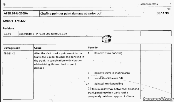

32 the rubbing thing I have also, I have been told some stick some felt on the plastic or heat it up with a hot air gun and apply some pressure to blend it in somewhat, I am going to get a heat gun on mine soon Ill tell you how it go's.
#17 ·
It was a MB fitter that told me the heat gun thing, its only 1mm in it so he said.
