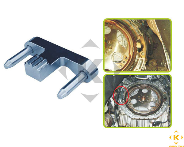

Found a rear main seal tool that was used once by another DIYer on another 2006 E-350. He said it worked perfectly. I looked up part number on Kommen website but was unable to track it down. It looks identical to the Baum tool and am assuming it is a knock-off. Either way hopefully will only need to use this once so not that concerned about it especially knowing it was already used on another M272.
Spoke with the guy and he gave me alot of useful tips. He only used a generic scan tool to clear the CEL and it seemed to work fine. No resetting adaptations or relearning cam position, etc. Assuming computer did the relearning process automatically after driving it. He also said the tranny was bucking after the job was completed. He reset with manual procedure involving the car key and gas pedal. I feel much better after speaking to somebody who has recently gone through this.
