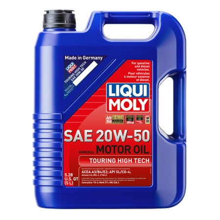

What oil should I use for the 280SE? Its a German import (not sure if that matters). I am going off what I find on google and just want to be sure before I change the oil / filter.
PS I am in Canada and the parts store here don't carry 15W40 / 15W50 so I am going with 20W unless you guys think I shouldn't.
Here's what's available in Canada - I also checked what FCP Euro recommends and its not the same as what I see in the manual...
The oil in there now is dark and I'm assuming has burned due to being the wrong kind? The inside of the engine bay is very clean and I'd like to keep it that way.

Castrol GTX is excellent. Used it for years in 20w-50 in my 67 230SL, but recently switched to Valvoline VR1 Racing oil that has Zinc for solid lifters (like the m110 engine has). But I live in year-round HOT Florida where I never start my roadster below 20 deg.Celsius and typically drive in 30-35deg.+ Cel. If you can get Castrol GTX in 15W-40.... Bingo!
However, If I lived in a Northern climate like Canada, IMHO 20W-50 is too thick for starts at 10 deg. Cel. or below as it won't flow as quickly during the most critical first seconds after startup. Having the correct weight is perhaps more important than which 'brand' of oil. Whether it say's diesel or not, look at the gasoline rating on the oil; if it's Service rating is SL, SM or SN it's better lubrication than what was available 40 years ago. -JMO
