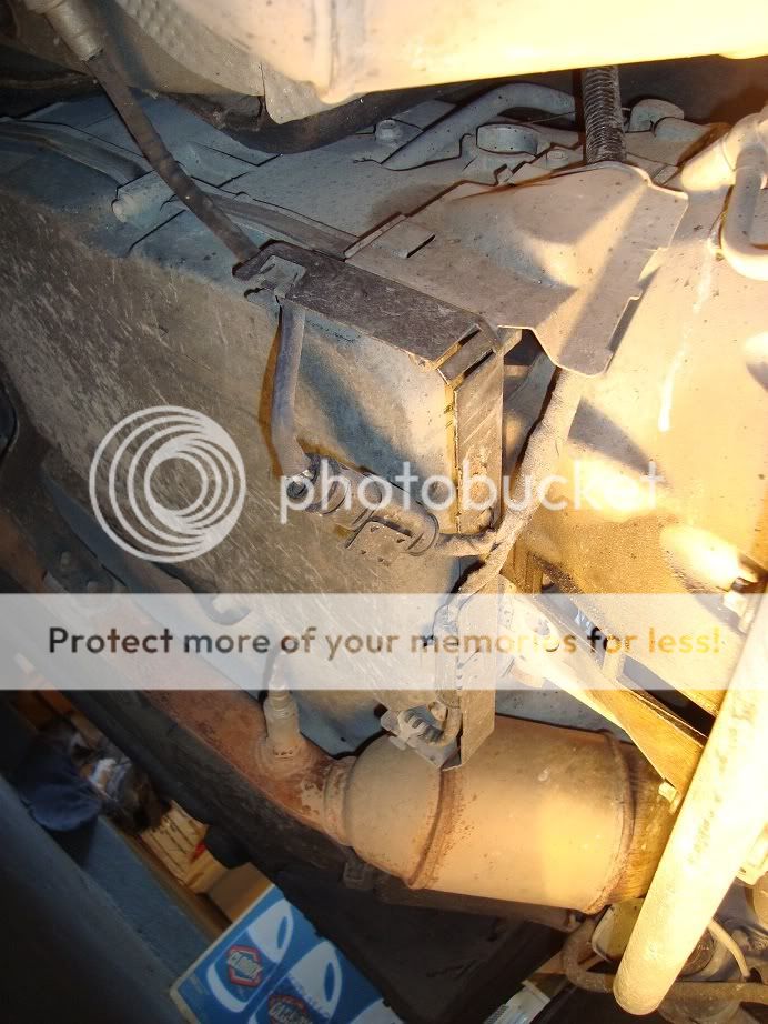

What the underside looked like, when I first jacked up the front end.

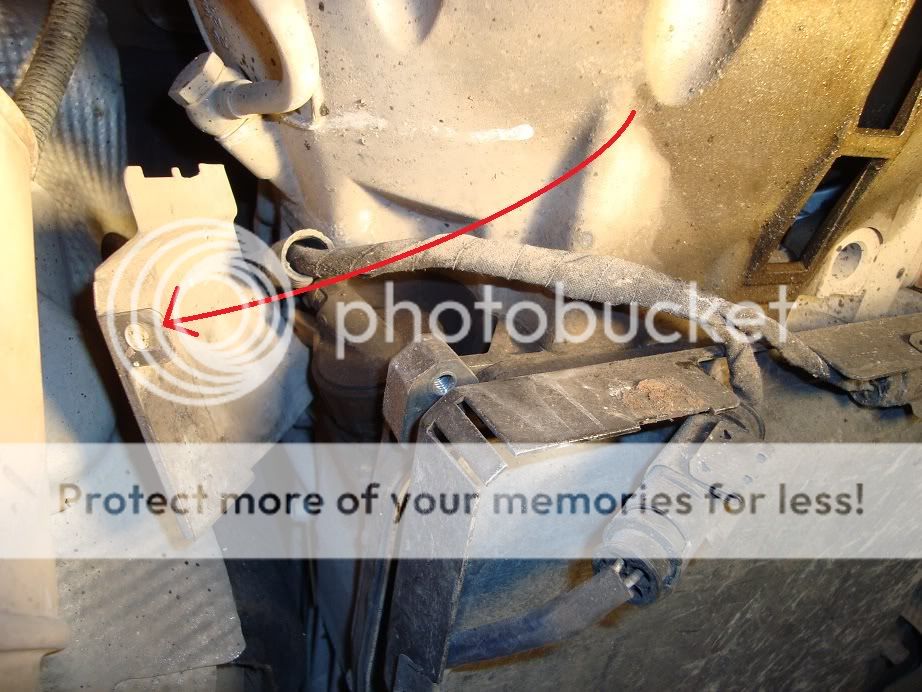

Pull down the wire connector (fastened with a clip) to reveal the screw that holds the shield in place.

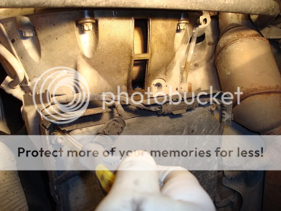

There's a star pattern screw hidden away under that harness that I just pulled out of the way, unscrew it.
Once the bottom screw is removed, simply push the thin metal shield out of the way revealing the connector.

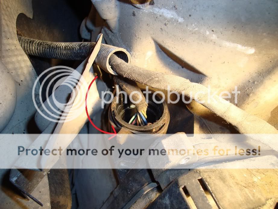

Better look at the connector.

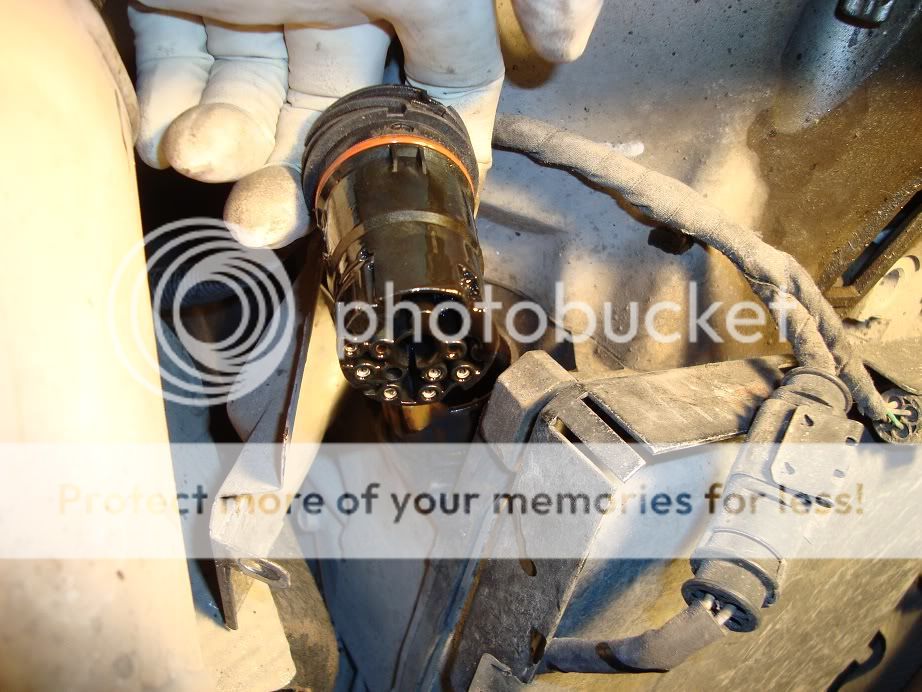

Twist the plastic white tab towards the bottom as the arrow indicates. The twist motion pushes out the wire harness connector.
Once its released, pull it out the rest of the way, out of the way.

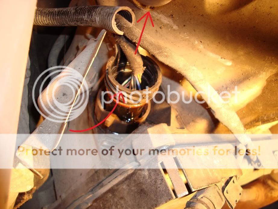

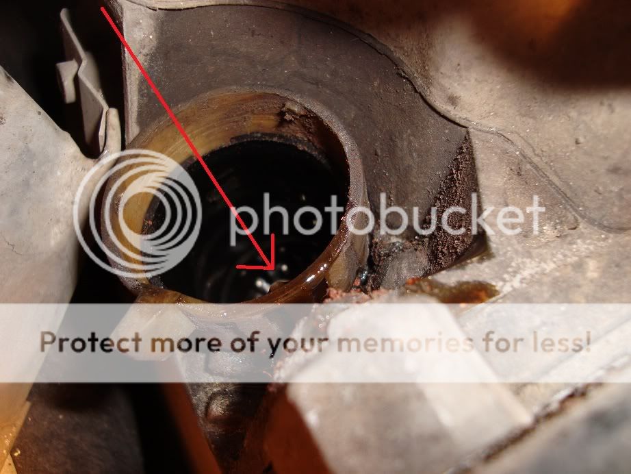

This is where the problem comes from... the oil leaking into the wires, as you can see its drenched in oil.

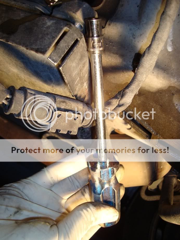

There is a 7mm bolt in the center of the connector where the arrow is pointed.
7mm setup to unscrew the bolt.

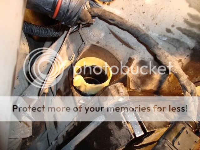

This will allow you to pull the connector assembly out, this is i the part you'll be replacing. Closer look at the connector you'll realize that you did not have to purchase the whole connector, rather just the two o-rings that go bad over time. The connector only cost $15 from the MB dealer, the o-rings would've been $1-$2, so not a huge savings there either. The o-rings I'm referring to are pointed out by the red arrows.
Once you pull out the connector, this is what you should end up with.
The old and the new connector.
The new connector in place, with the 7mm bolt tightened.

Agree with gurunutkins that the single O-Ring on the male plug and TCU harness is just to keep out dirt and water.
Wish I had a photo, but recall that the conductor plate shown in guru's post is a solid cup at the bottom - with the electrical TCU leads going through a molded connection on the bottom of the cup.
The adapter plug has two O-rings. O-ring #1 is for sealing the top of the cup of the conductor plate to keep transmission fluid from filling this connection. Fluid in the cup gets wicked up the harness cabling via capilary action. O-ring #2 is for sealing the aluminum transmission case to keep fluid from leaking out. (IMHO)
See corresponding sealing surfaces on Kruso's marked up photo, and the gap between the conductor plate and the transmission housing that is bridged by the adapter plug.
And this link is just one recommendation for not buying a URO part for this application.
http://www.benzworld.org/forums/w163-m-class/1607399-transmission-electrical-plugs-beware-uro.html
#27 ·
Yep as atmsmshr says the plug is totally sealed from the fluid.
the cone on the conductor plate has the pins sealed in the bottom of it, no fluid can get in from the back of the pins. when you push in the connector tube it has holes in the bottom that the pins slide through but it seals - using the first o ring - to the inside of the cone on the connector plate.
The second ring on the connector tube seals the tube to the transmission casing so the fluid cannot leak out through that joint.
that means that once the screw in the center of the connector tube is tightened no fluid can get into the connector unless the o ring leaks. Its actually possible to get the 2nd o ring leaking and get a leak from the transmission but not into the plug. Similarly if the 2nd o ring doesn't leak but the first does you can get a leak into the plug but not around the transmission. If the male oring is good at that point it will only leak up the wires of from the wire bundle.
