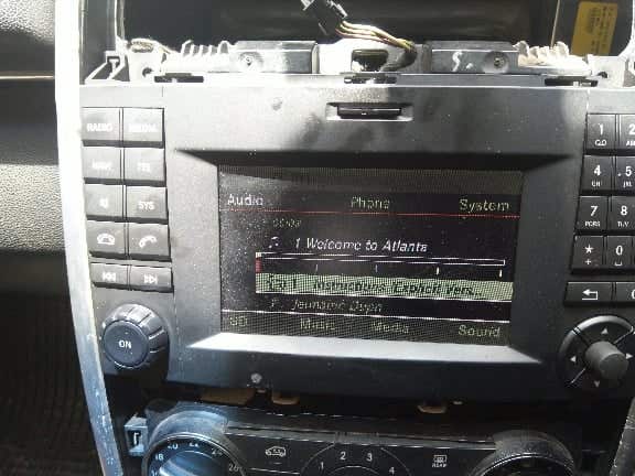

Hi All,
I have decided to set my course to some unchartered water. I decided to upgrade my audio from Audio 20 MF2752 to the latest audio RY2550. Advantages of the latest is that it has Bluetooth Audio, Reverse Camera, Bluetooth calls, Navigation, USB, SD card and line in.
I am looking for any who has tried to install reverse camera and where to install it and where I can get a compatible one.

The sound quality and output from this radio is out of this world. I love it's engineering.
The PIN config is almost the same.
The pink Fakra is USB and the green Fakra is reverse camera. I read this in wis. The issue is getting a camera that would fit somewhere in the boot and at the same time be compatible with Audio 15.
