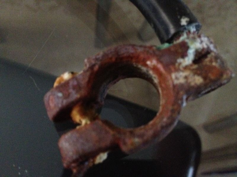

I went to start my car yesterday and all I got was a single click, I presumed it was a dead battery (battery is about 3 months old) car is not used much, when I took the battery off the earth terminal was wet and rusty, in fact the nut has rotted away the terminal pulls on and off the pole with slight force, I dried the pole charged the battery overnight, I put the battery on this morning and I still just get a click, I know the battery is fully charged and is healthy, if the battery was faulty my charger would tell me.
Where is the moisture coming from on the negative terminal nothing else is wet?
I have replaced the earth strap, the old one was a mess, there is nothing else under the seat that was damp just the earth terminal.

As you can see, it was in pretty sorry state, it certainly wasn't worth saving and putting new end connector on, I just replaced the entire strap, when I pulled the rear seat up and looked at it I was shocked to see it in such a bad condition.

First the cable shows acid marks on it, what could be indication of overcharge. You never check the car voltage and this is second indication that something might be wrong with the charging system.

when I took the battery off the earth terminal and negative post was wet which made no sense to me as everything else was completely dry, nothing had leaked out of the battery as it was dry around the caps, the battery levels were good.
