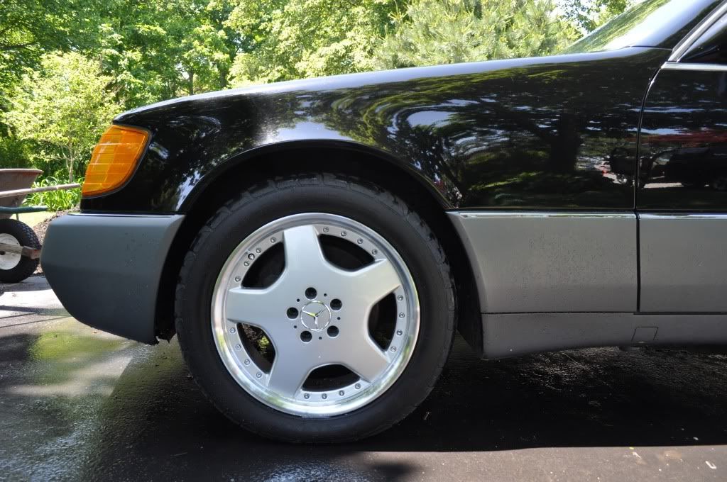

AMG Monoblock Aero2
Front: 19x8.5 ET46 255/40R19 - Continental
Rear: 19x9.5 ET46 285/35R19 - Continental
No spacers, stock suspension. No issues
AMG Monoblock Aero2
Front: 19x8.5 ET46 w/ 245/45R19 - Michelin Primacy
Rear: 19x9.5 ET46 w/ 275/40R19 - Michelin Primacy
Carlsson Evo1/6
Front: 19x8.5 w/ 245/40R19 - Michelin
Rear: 19x10 w/ 285/35R19 - Michelin
No spacers, had plastic hubcentric rings and shorter lugs. No rubbing

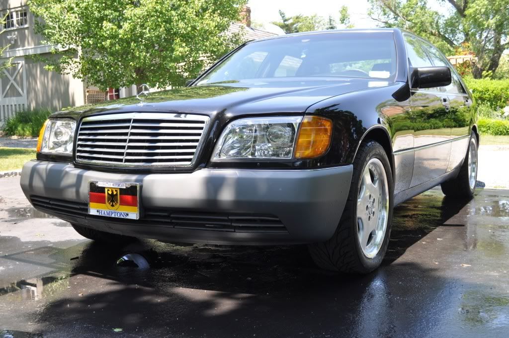

AMG monoblock
19x9.5 et 46 Pirelli Pzero rosso 285/35/19
19x8.5 et 44 Pirelli Pzero rosso 255/40/19 *Best summer tires,ever!
all stock/ minimal rubbing front and rear under fully loaded car ONLY when there is a big dip in the road
AutoCouture Supreme
20x9.5 et 38 Bridgestone 255/35/20
20x8.5 et 36 Bridgestone 285/30/20
AMG monoblock
18x8.5 et 44 Yokohama 255/45/18
slight rubbing in the front left under the same conditions as above
**Your car might not rub in the front like mine, i think mine has a slightly out of place wheel well plastic, and rubbing is minimal and on the outer shoulder of the tire.
