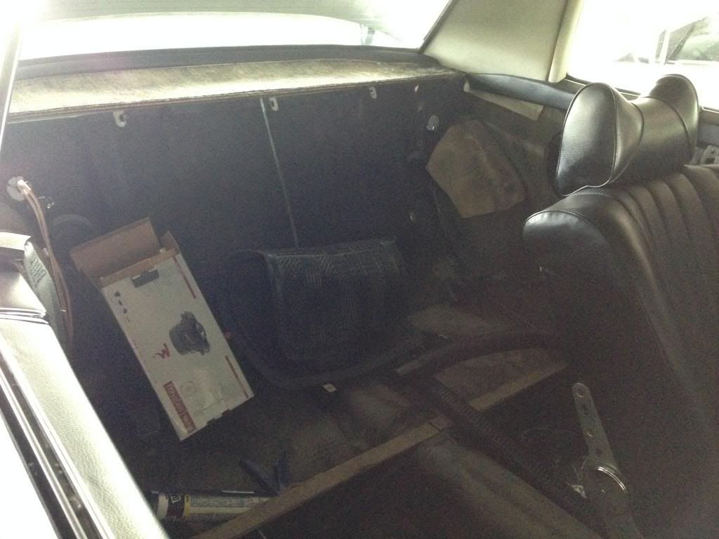

Interior: I found a major problem with water leaks on the car. I had to address them before moving forward so I ripped the carpets up, took everything out and found the weak spots. Turned out the drain holes from the compartment under the grill in front of the windshield were blocked. The water would come into that location and overflow. Unfortunately thats where the heating or AC system would suck in air so the water would then go through the piping and empty out into the rear driver and passenger footwells. The Drainage plugs are located in the engine bay and are covered by two rubber flaps. The other weak spot was in the roof. The metal trim that runs along the sides of the roof had come off towards the rear of the car exposing 2-3 holes that lead straight to the interior headliner. Water would enter those holes and drop from the headliner down into the car. Plugged those and adhered the trim back the way it should be. Thankfully there was no rust or any sort of permenant damage from any of these water leaks. I assume the previous owner didnt take the car out in the rain much and I saw that he had stored the car in a garage.

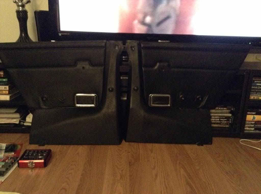

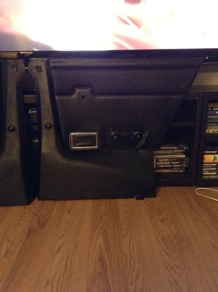

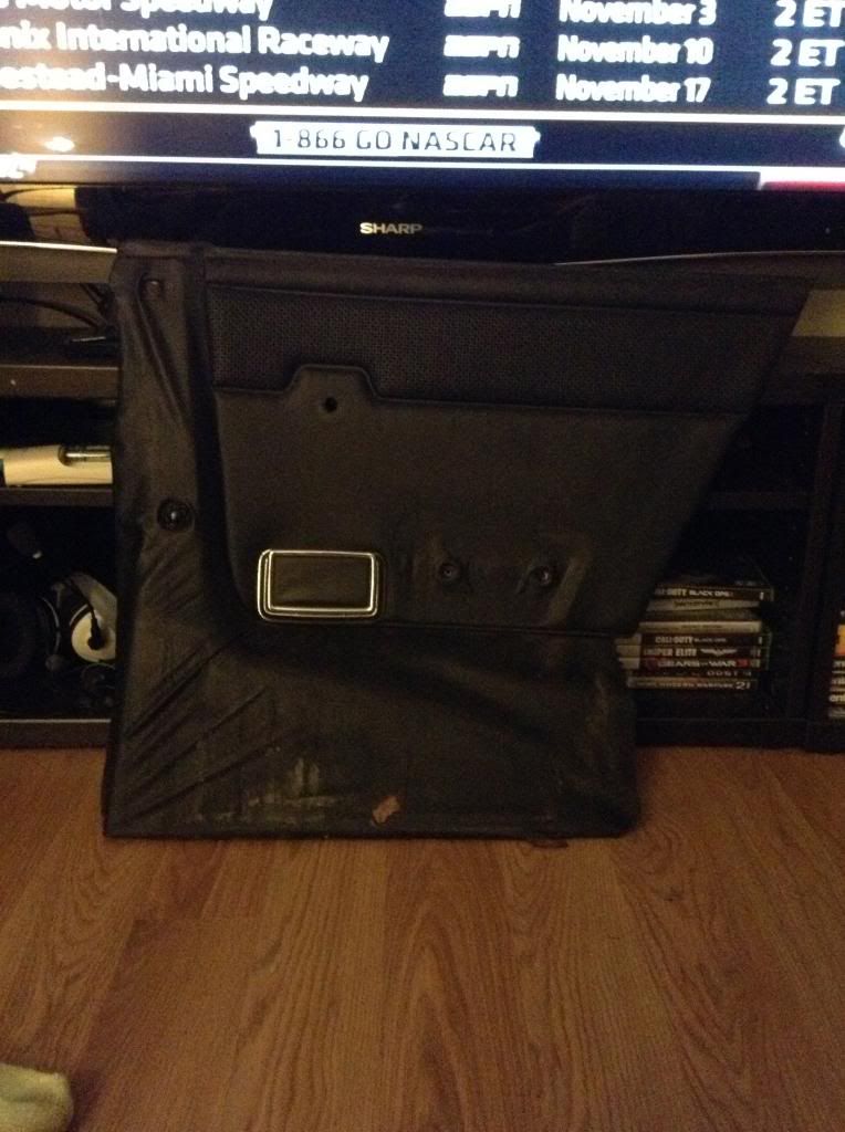

Lastly I saw that the leather had come lose on the rear panels. I was able to tighten them up and use some of my upholstery skill to make them look pretty good again. Here are before and after pics.

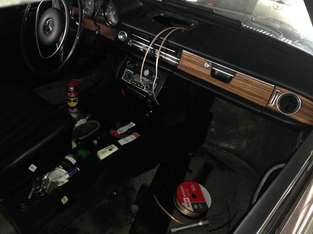

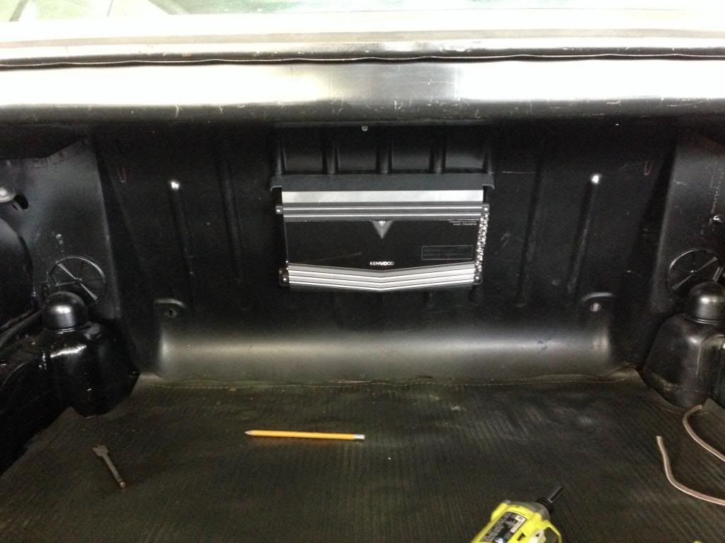

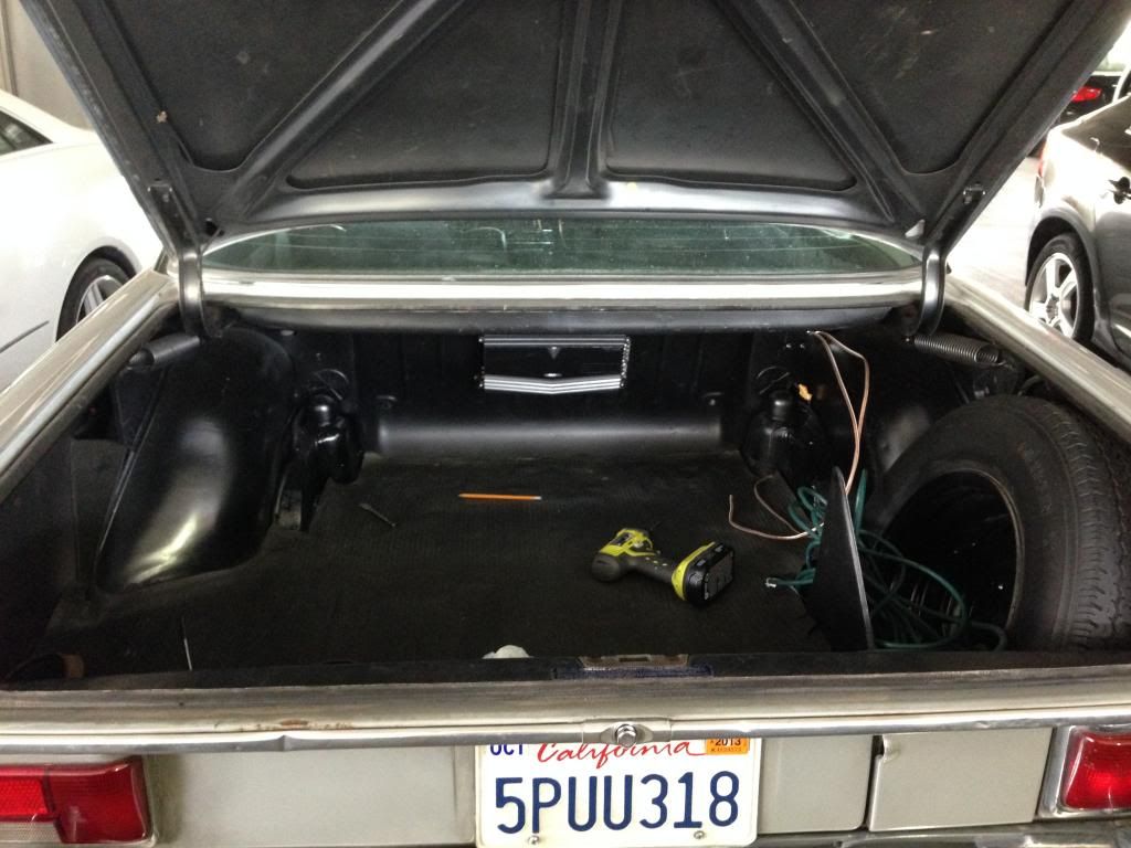

PLANS: Right now I am taking things step by step/ Ive put things on a priority list so first of all was the motor. Its running just fine for now so next was the water issue. Once I fixed that, the new stereo wiring has to be run. Once thats done a false wall will be made in the trunk to hide the amplifier. A new carpet kit will be installed and I will dye the headliner black. I have been conditioning the leather seats and panels for about 4 days.
