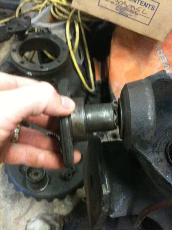

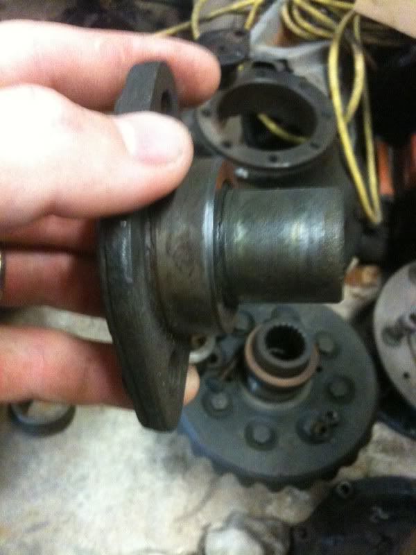

Hi guys i have a 406 steering axle with no identification tags on it nor is this axle in a 406 its for a custom project and i need to replace some parts on one side kingpin they look like this
the following is the top kingpin

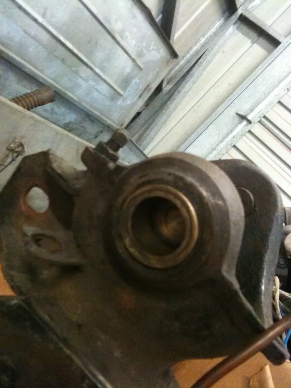

it slides into the knuckle into a brass bush it looks like this

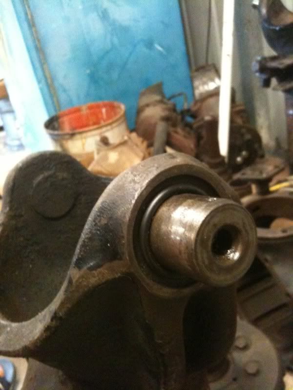

this is the bottom kingpin which is in the housing

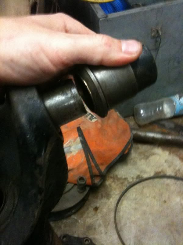

and this slides over it

Looks like an early "F" axle from a 406, most likely a 65'-67' vintage. I bet the portal gears are not straight cut, but are more like the 404's and are not the same from side to side. So there is a left side and a right side to the gears. The straight cut gears are a bit beefer as well. You should be able to get what you need from Scott at Expedition Imports.
