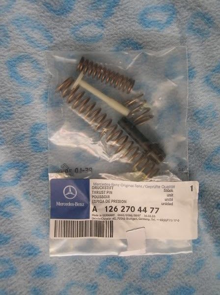

There is a kit to repair this issue, a spring and plastic piston parts kit
for the valve body. An update if you will. The part # 126 270 44 77
Here's the kit, your Mercedes tech should know about it and be able to install it.
I'll see if I can find the work instructions on WIS, if I do I'll scan and post.
I did it on my prior transmission and it worked really well. Very easy to do as well...Part should be less than $15 in todays dollars.

Why haven't you mentioned the kit above
that could fix this issue?
Yes, I did mention the kit to my MB tech, he didn't think it would be it.

It's a known issue with a Service Bulletin.
You want to live with it or try something
that may fix it, but won't cause another problem?
Maybe he doesn't "want" to install it?

No, the kit is not an automatic part of a rebuild.
Though I personally install them on older transmissions
if I don't know the history of a unit.
I would say 1.5 hours is the maximum labor.
Very easy update for an experienced MB tech.
No, it does not cause a new problem, even when
installed on a transmission without a flare issue.
