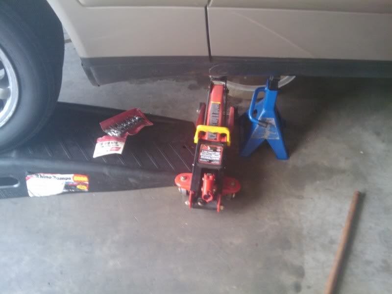

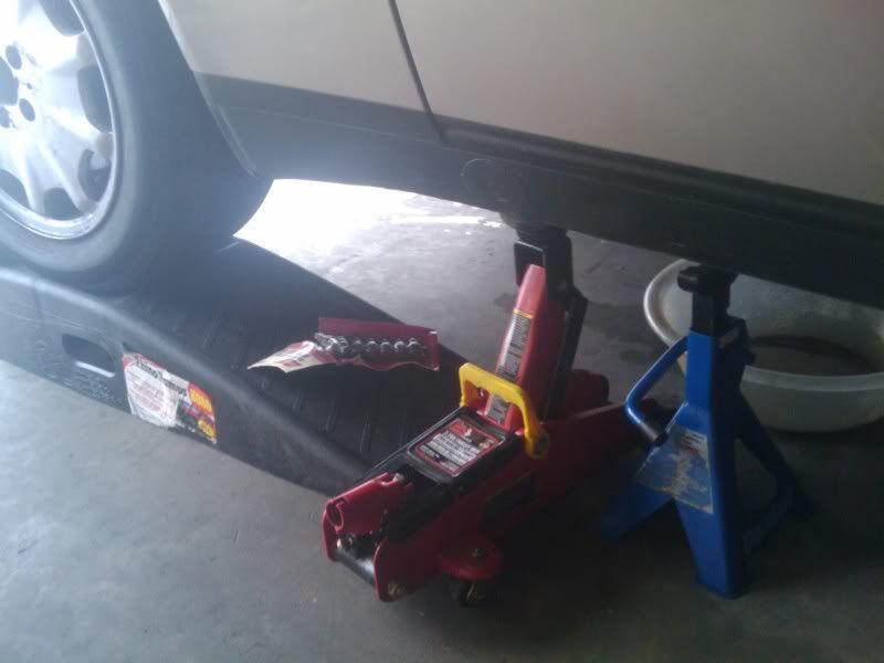

Call me paranoid but atleast Im alive to hear you call me it. ;)

you must be one of those guys who double wrap it:D
no such thing as too safe. if you have all the safety devices, use them. i usually just choke the rear wheels and use jacks stands along with heavy duty car jack. if i have wheels off than i put wheels horizontally under the car also.

Agree ... better safe than sorry ...
I use Rhino ramps as well and use a hydraulic jack on the cross member behind the engine meant for this purpose or under the differential when working on the rear end. I also locate jack stands at the proper locations as needed.
I do not drive the car up the ramps but raise it and locate ramp under the wheel and then lower it.
You might want to read the attached article on how to properly raise a Mercedes with a jack that covers both the W210 and W211. Hope it helps.

I bet $10000000000000000000000 the hose is secured.
Yeah the rhino ramp is securing the hose with the cars downward force in case gravity decides to take a nap. The hose through the car jack well thats just embarrassing, pardon me but 3 points of failure is better than 1 :D

Having some mechanical education I have to point that in this case more not necessary means better.
Ramps and stands are pretty safe devices if set RIGHT. Meaning they have the load placed where the engineers design.
Now with this set up if the stand is just standing with no load on it and the car will start rolling down the ramp -the stand will tip over in split second.
Than what good ramp does when you have no bolts holding the wheels? ;)

The best comment for this thread!
