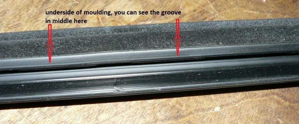

First door was tougher, pulling up on the trim was more difficult. You can use a broad flat head or a chisel wrapped in duct tape. Also a plastic spreader for plaster could be used if you can find a stiff one.
Second door was easier. Key is just to pull up hard on the trim at the end of the door closest to the B-Pillar. This is where the only clip is located. There is a plastic plug at one end of each trim piece, that can stay in place for both old and new during removal/installation. Once you get the trim off the clip, the rest of the trim just pulls of the metal tongue inserted into the groove of the trim piece.
Once the old one is removed, clean up underneath and get the new one ready to install. Start with the trim end opposite of the clip location on the door, snug it up firmly and start the groove on the metal tounge protruding from top of door. Just keep pressing it and move towards the clip. Make sure the end you started doesn't back off from where you snug up it up against the window frame.

Back side of trim, note groove in middle:
