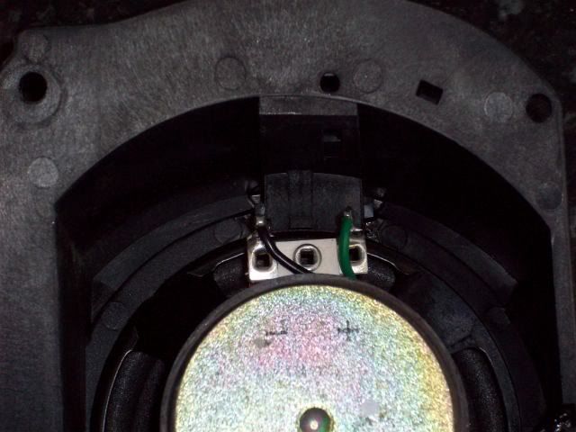

Now, go back to the original speakers, make a note of how they are wired and cut off the plugs with a couple of inches on cable.
On mine, black was negative. Splice this into the harness that you get with the speakers
