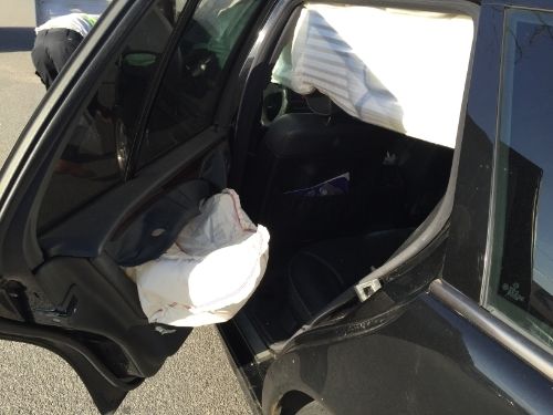

On my way to the mechanic to change the front drive shaft. 5 blocks away.
No Accident.
Spontaneous Simultaneous Airbag Deployment!!
All but the steering wheel, front passenger and passenger front door......
SPEECHLESS, HEADACHE......THEN TEARS.

That is truly unfortunate, and I hope you or no one else were injured. Those airbags can give some serious friction burns.
If I were to take a guess....the driveshaft with the missing needle finally gave away and hit the transmission tunnel.
There is a sensor in the SRS module that monitors for any form of serious shocks. I don't remember the exact value, but it is in excess of 2G. I would venture to guess that you now have a driveshaft lying on the floor, and a hole in the transmission housing.
I wish you the best luck in getting her back to condition...but it's unlikely. The insurance will total the car, as these airbags are very expensive to buy new.

Actually there was nothing on the ground. Nothing dropped.
I had Triple A come get it and turned around on the same road and took it back to the front of the house...smh
Just put in a new fuel pump, battery, radio and brakes.
I will call the junk yard tmrrw. There is no way I'm replacing all those airbags:-1:

Talk to your insurance agent first. Usually, yes the car will be totalled, but that's because your insurer, seeing the bags blown off, is assuming hidden body damage they don't want to mess with. I forget the exact number, but normally those will fire at 22 or so MPH with an impact. You had no such impact, and it would be fairly easy to prove.
Much more likely you had an electrical fault that shorted some impact sensor wiring together. It's going to be difficult to find, but it can be done.

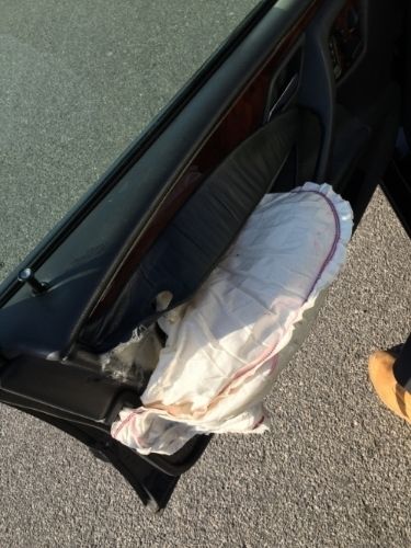

Why don't you just remove the deployed arbags, if there is no other damage? They should be replaced after 10 yrs anyway and the system inspected, if you are truely concerned about their function when needed.
I've been seriously thinking about trying to repair her. I found a donor I'm going to check out tomrrw. Its a pre-facelift but if I'm not mistaken the door panels are the same. Just wondering what i could do with the top curtains that deployed. It looks so scary in there. :( Maybe i can just cut them out....smh
Any suggestions or anything i should know before attempting this?
Thanx in advance

I am afraid if you cut off airbags, you will have constant SRS light and what worse, likely that will disable whole system.
Did you ever get to the bottom what created the impact?

Usually when the airbag goes off, the SRS module is rendered unusable, and needs to be replaced. The module is basically one giant capacitor that stores electricity, and on the event of an accident (also when the battery is disconnected in the said accident) it discharges all stored electricity, burning itself out. The SRS module, all airbag squib plugs are one use items.
Safe to say that there is no functioning airbag system going on at all.
