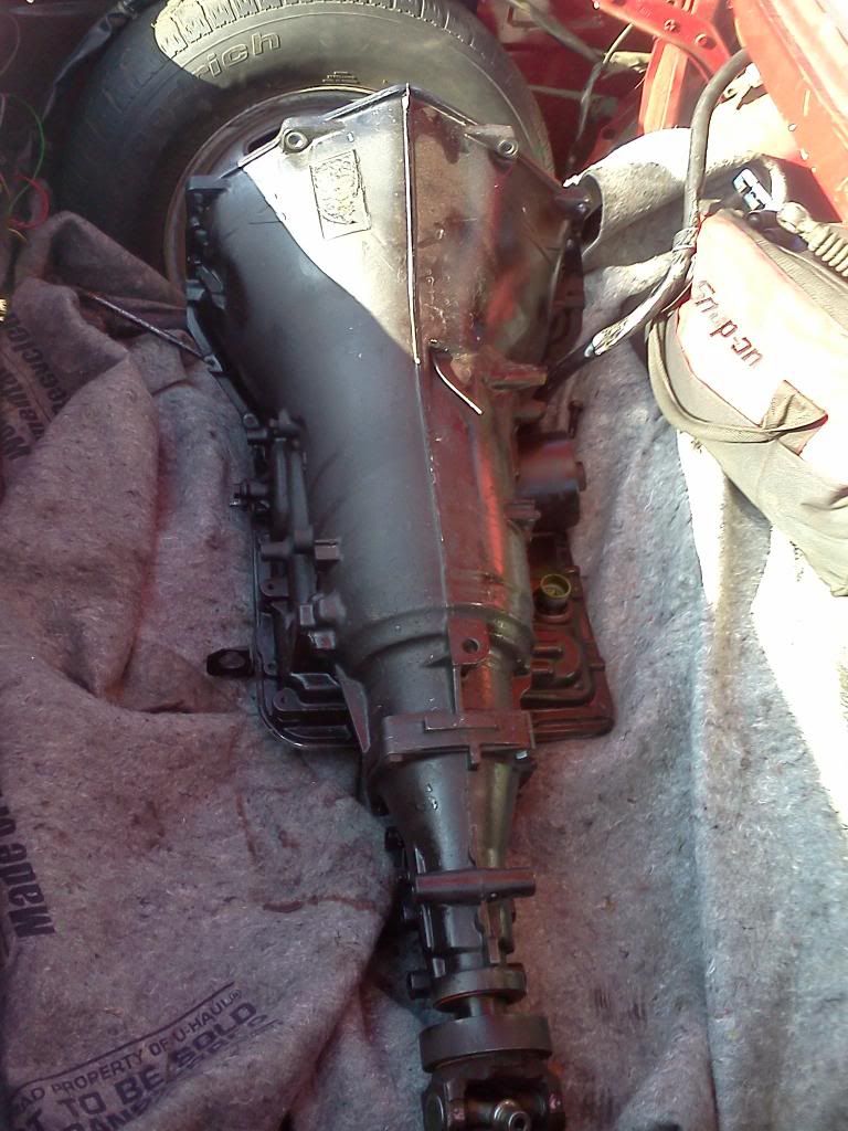

Funny you should mention that. Yesterday I picked up a rebuild 4l60e with a new torque converter off craigslist.
It's from an LT-1 Firebird (Gen II V8) so I'll need a spacer for the torque converter to mate up with my flexplate. It should play nicely with the LM7 wiring harness and PCM.
