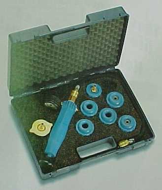

Lots of extra stuff to buy to do this. The cap adaptor is one part, but the vacuum setup with gauge, etc is another. Where do you get that setup that will check pressure while drawing in liquid?
Yes, I know there are alot of things to get... Please note, though, I am one of these anal people who like to do things "by the book"... thus, I tend to have on hand the WIS specified tools and procedures. My posts are geared to be more of a "color pictorial" of the WIS black and white "written" instructions.
There are TWO options for the Vacuum systems...
A- The "Cheap-O"(relative) --> I have one of these "Fleabay" systems... funny, they were like... $60 bucks not toooo long ago.. now nearly twice that..
UView Airlift Cooling System Leak Tester Airlock Purge: eBay Motors (item 350326524547 end time Jul-07-10 16:31:14 PDT)
No experience with this one for a Pressure tester: STANT 12270 RADIATOR COOLING SYSTEM & PRESSURE TESTER: eBay Motors (item 260621090078 end time Jul-16-10 11:08:26 PDT)
B- the MB OEM system, which, like many things, is supplied by another maker.
In this case, "Leitenberger" makes both the PRESSURE TESTER, and the Vacuum systems, as well as the Refractometer (to supply to Hazet AND MB).
It's funny how the SAME exact product can vary so greatly in price, but, in my case, some of the items I got cheaper from the Dealer, other's thru Hazet, and some from Leitenberger itself. You don't want to know how much these items are, though......
Anyway, here is the list for "reference"-
Here's the Pressure testing section:
Cooling system testing equipment
you can also get thru Samstagsales.com-- http://www.samstagsales.com/images/hz4800-9.jpg
and here is the Vacuum Fill Section:
Vacuum cooling system filler
CO2 Tester: CO-2 Leak Detector
Refractometer: Refractometer for radiator antifreeze, windshield washer fluid and battery acid
To be perfectly honest, the "Airlift" (el Cheap-o) with it's "Universal" (Cone shaped Rubber stopper) connector works equally well as the high-end Leitenberger set-up.
One caveat, though.... I don't think you can "reliably" rule out a coolant system leak by SOLELY relying on a "Vacuum Leak" type test. Sooo, to use the Airlift system as both your TESTING, and FILLING.... that's up to you.
The reason I use the Leitenberger is: the Adaptor cap will work for both the PRESSURIZATION test as well as the CO2, and Vacuum-Fill operations.
