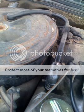

As you can see there's oil coming out of the hose that goes from the air filter into the top of the motor....anyone have this problem before?

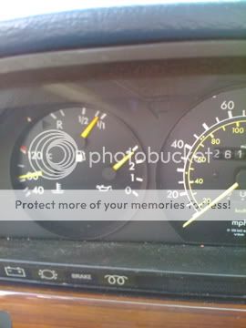

Not sure if this is related but since we're talking about oil....Is this normal running pressure for oil?
Thanks!!
1987 420SEL
1,133 Posts
That's your oil pressure @ idle? Looks pretty good, pegged, as a Merc diesel should be.
I'd replace that hose with a new one. The new one will be fresh rubber, and, being more pliable, will seal around the valve cover port much better than what you have now.
I wouldn't worry too much about the oil, it's a diesel, but I would replace that rubber hose.

That's the pressure at about 2k rpm's. It runs about 2 to 2.5 at idle.

If that's the most oil you've got coming out of that SD then it might not have any oil in it!!! :D That's the breather going to the oil separator inside the cleaner housing. I second the new hose or you can put a small swab of permatex aviation sealant on the hose and reinstall it. It won't "sweat" that TINY amount of oil then :)

Yeah, that's not too bad, but even with a new hose and tightened down, mine still did that. I used a Lubro-Moly product, forget the name, added it to the engine, let it run ten minutes, than did a normal oil change. Hasn't leaked since.
