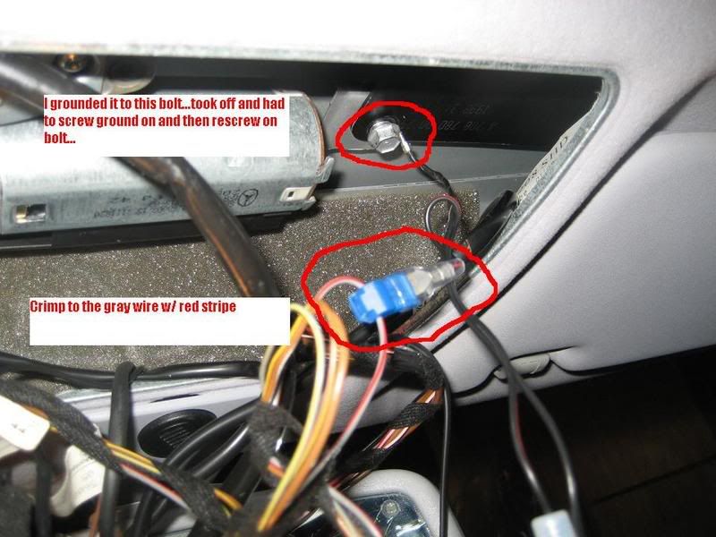

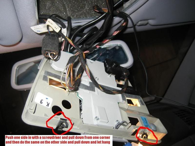

glad i could help....but sorry i dono wut that is? i can check when i get in my car later but i probably wont know lol....

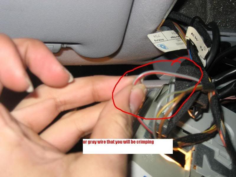

JOE55 - lol hahah thanks...na but those nails are useful ...esp for takn out my braids and were useful for that fkn hardwire....broke like 2 of em tho tryna uncrimp that blue thing cuz i crimped the wrong wire the first time LOL...

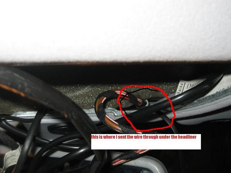

btw...anyone know another wire up there or around the area that i could tap into...because i tried hardwiring my passport gt1 to the same wire but then either the radar or gt1 lose power....i guess its too much power for that one wire so it wont work.....

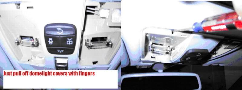

also, my domelights got fukd up sumhow while i was doin this....anyone know wut could b the prob here...?

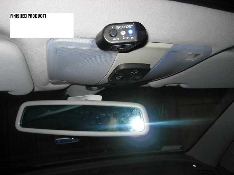

good job on the install. I finally bit the bullet and picked up a V1 last night. I'm thinking I would like to put it somewhere discretely. Under the rearview mirror isn't exactly discrete but it's a popular place. To the side of the rearview is more discrete but it would get in the way of the visor. Then I thought of the lower left area of the windshield where I can see it much easier but the detection may be hampered. I'll probably try to hardwire it to the fusebox, that way (hopefully) I can just plug it into an empty fuse slot and not have to do any splicing.
