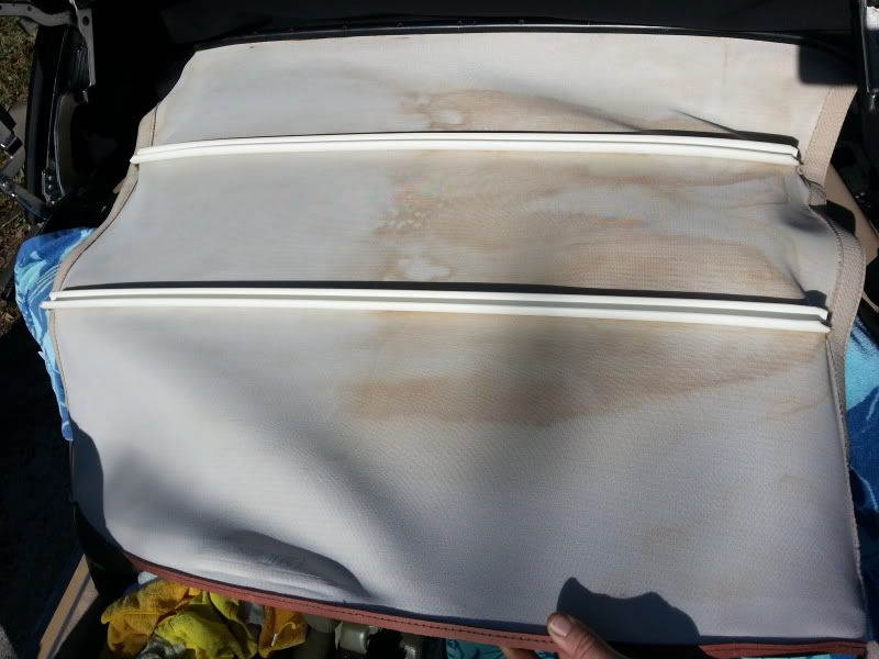

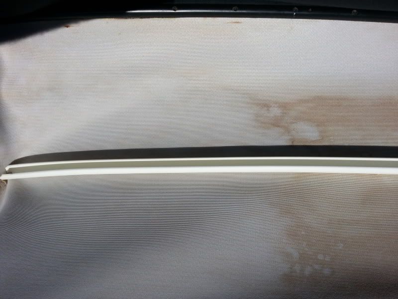

Cleaned on the Car
I decide to clean it while leaving it on the car. Here are a few photos of the water stains and the progress. I used the "Turtle Wax Oxy Interior 1" which I found in the Automotive section at Wal Mart. The pics are of the Underside of the Headliner.
Before Starting the cleaning:
After Cleaning the Passenger Side:
I actually finished it yesterday evening, but it was too dark to take any pics. I will post a few completed pics today. Those water stains were showing through to the side that you can see from the cabin of the car, so removing those water stains from the underside of headliner really helped clean up the interior. The headliner looked pretty skanky from inside the car.
