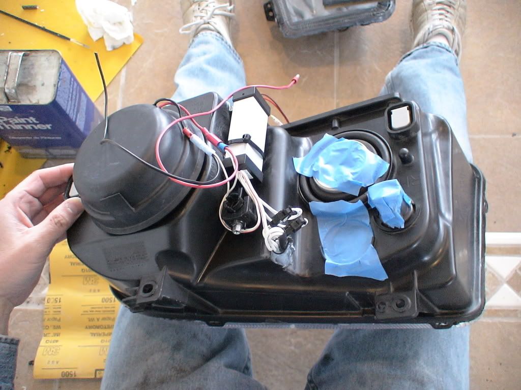

2)-If the headlight is removed, cover the openings left from the removed headlight bulbs so no dirt or water gets inside the housing during the procedure. Clean the headlight with soap and water, and dry it completely.
NOTE: Disregard the extra wiring shown in this photo. This is for the halos and LED lights installed in my headlights, not found on standard Chrysler products.

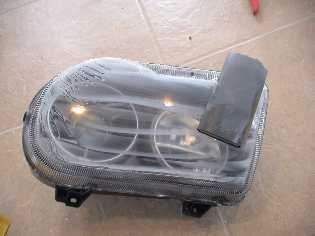

There is often a release agent (for the plastic mold) on the surface of the plastic that must be removed entirely with the sanding or you will see a cloudy area where it remains. I did not sand enough on my first run at this and you can see this area in the center of this headlight in this pic.
The headlight will look dull at this point:

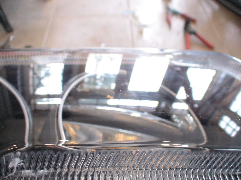

I was pressed for time on this, as I was not planning on doing this initially and really needed to get the nose back on my car before nightfall. I didn't sand as far as I should have to remove all of the original pits, and cut some corners to get it done fast. The end result is much better than what it was in the start, but I plan on doing this again thoroughly when I get the chance.
In this "after" picture, you can see the improvement, although there are still many nicks that I am going to have to attack later
