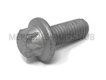

I was putting all the 3 bolts(the ones that hold the pump to the motor) across the high pressure fuel pump. Unfortunately one of the screws heads broke off when i was putting it in place(it also had some rust in the middle where it broke, so i can see why).
So now i need a new screw, and i would very much like to buy it new. Does anyone of you have a reference number for those screws? They're torx but they're male torx instead of female.
It looks like this:

For part 50, no it's not like that, i'll post a picture asap. Its a bosch Cp1 high pressure 0445010008 in the front of the engine bay, picture coming right now.
Edit:
The pump is there,
2656396
The bolts are like that
2656398
Missing bolt:
2656397
The 3 bolts around the pump are the same
Also they look common M8 thread, but are they really?

The short answer is you can, and I would not have a problem with it on my car.
The longer answer, is that bolts are designed to stretch, and the harder the bolt, the less it stretches when tightened. The amount of stretch a bolt has helps determine the torque spec as well, and I am sure there are other engineering theories that would argue against putting a different hardness of bolt in there. Bottom line is, your bolt didn't break from stress, it broke from rust, which means the harder bolt is probably not going to make a huge difference. But it may give you some piece of mind.
BTW, anytime I need a metric bolt this is where I go : www.belmetric.com. They have a lot of great stuff on there, including the factory hose clamps, among other things. I dont think they had the specific bolt you were looking for, but they did have some flange bolts that would work, in a 10.9 or a 12.9.
