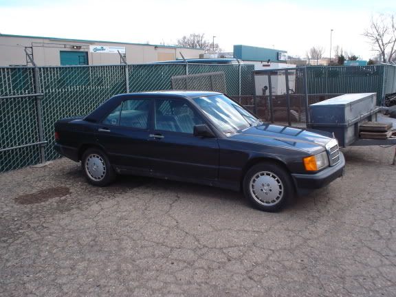

man those lights look hot. yeah black is definatly a nice color. so i got a new fuel pressure reg (well a used one) and put it in, but what i misdiagnosed earlier is that i have no pressure up to it (it needed replacement anyway). I can not hear the fuel pump (supposed to be in the trunk right?) when i switch on the key. i checked the relay and didnt see any burnt circuits- i am not sure if i got the right one as it didnt look like the picture posted on the repair a relay thread, but it matched up to the part # from the online manual.... any ideas? what else could it be- the pump?
the pump isn't in the trunk, its under the car. a plastic panel is protecting it.

well, in the quest for finding the lack of fuel fault- i jumpered terminals 30 and 87 where the fuel pump relay would go- and the pump didnt turn on though the jumper wire did have power..... any ideas? it's just eating me up that it wont run! i can use start fluid and it works great... oh well. please some ideas! is it the fuel pump? are there any fuses between there and the fuel pump that could be bad?

Sounds like your problem might be purely electrical though... if it runs, do you hear a clear buzzzzzzzz from the area where the fuel tank is?

My god! i got the bitch running! replaced the fuel pump with one from a 300E... i've never seen a 2.3 Liter with an automatic be that powerful! i was spinning tires and everything! so much fun to drive! today was a sweet day- got 2 fuel pumps, a fuel filter and the other little thingy from pick and pull (off a 300E) and swapped in one of the pumps. started right up! drove it around and had a lot of fun!
