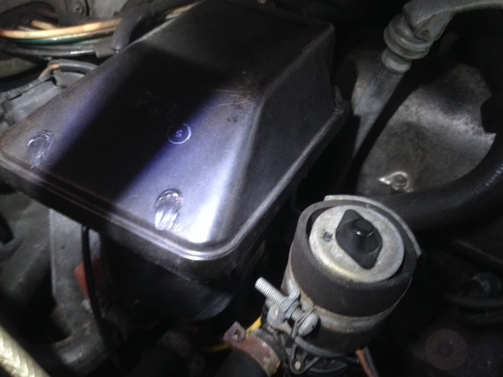

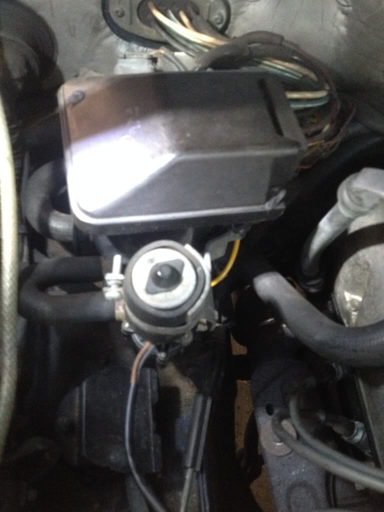

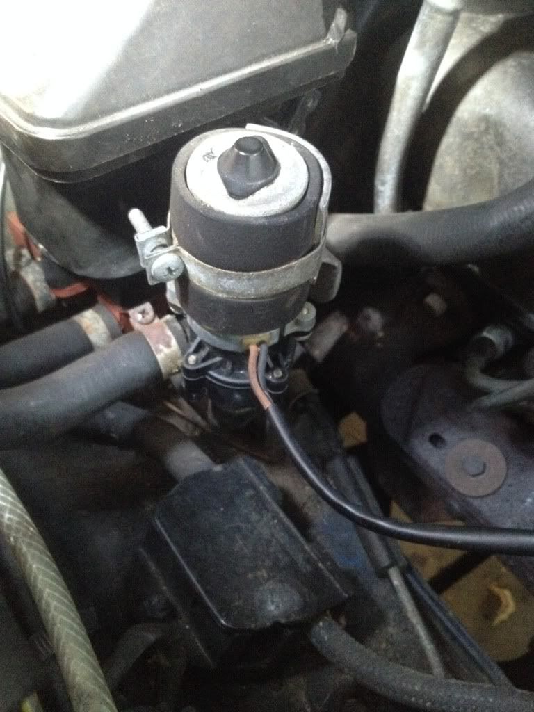

Not sure if you have a mono valve and aux heater pump but if you do they need to be checked.

This morning all hoses running to servo got hot with defrost running. I noticed however when i pushed bi-level button i could hear it switch over but was not blowing out. when I pushed back to defrost it ran and blew out well.
Also AC works great except does not blow out through middle vents. This just stopped happening the other day when I started looking for the heater problem. Any more ideas. All replies are appreciated.
