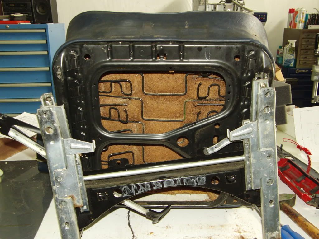

This is a total act of desperation. My seat was feeling a bit deflated so I went with the noodle overhaul on peach parts. I got the seat out of the car, no problem. Put it on the bench and started unscrewing the supposed 4 screws holding the track system to the bottom of the seat. To my surprise, there a 5 screws. Two on the right track, and three on the left! WTF! Now I cant figure out how to get the third screw out.
Can anyone be of any help? Thanks!

You did not have to remove the seat tracks to do the pool noodle fix in the first place.
I can see why it feels deflated, there are 3 visible broken springs from the photo!

Using the seat adjuster, slide the seat along the track until th screw is accessable through one of the holes on the bottom track.
Had to do this to convert a passeger seat to the driver side.

Your right, guess i didnt need to take off the track :eek:
I finally got it all put back together, i decided not to go with the $50 dollar spring fix kit on mercedes source. Instead i just jammed foam in there until it sprung back to its original glory. :D
