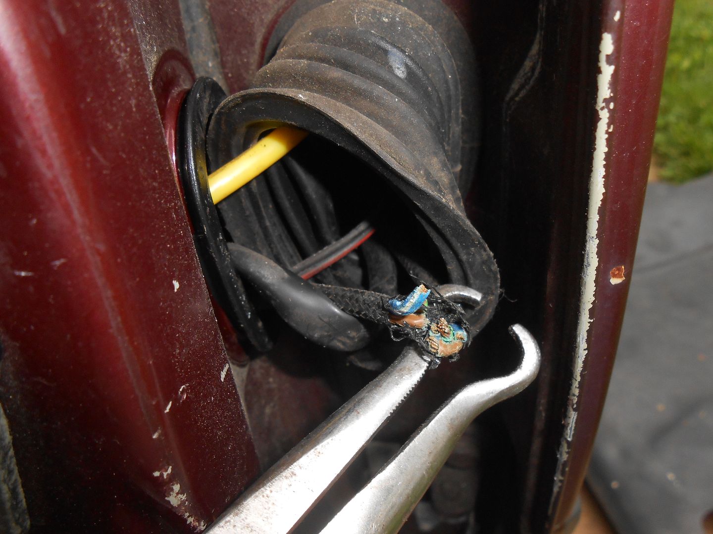

You could have shorted wires at the door hinge pass-through. Try unscrewing the two wires that go back to the car at your connector pictured above and test the motor again with only the wire going to the motor. If it sparks again you'll know your issue is with the door motor itself.
Here is an example of failed wires.
Here is the repair.
