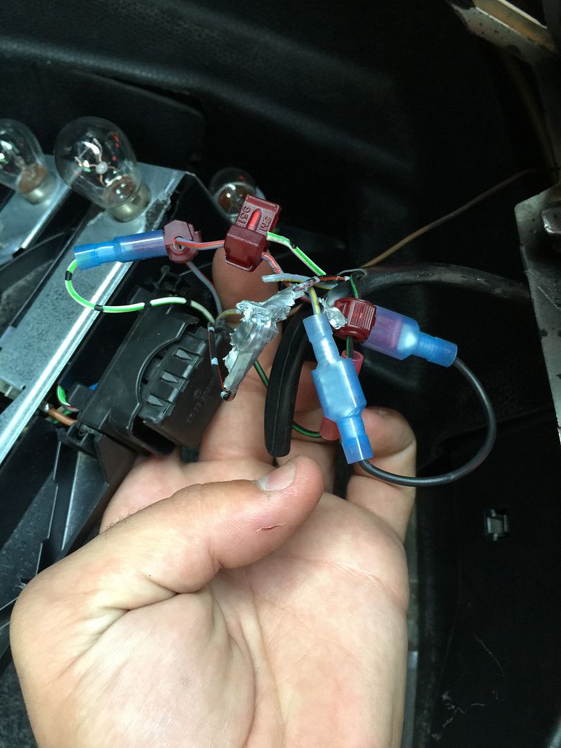

Had a chance to work on it today. Fixed the odometer and decided to pull dash apart and take pics. Also the fogs turn on and flash when the right blinker is turned on, headlights on or off. Whoever had this previous did some interesting wiring. The tails have wiring spliced as well that ill attach. And last week i ran some amp wires and found that right at passenger backseat floor where the factory loom comes thru under carpet there are 4 wires coming through cut. I forgot to take pics but can tear apart if needed but heres what i found. There are two power 12v, one direct and one fused, running all the way back to 2 wires there from engine bay. And then one wire is open and one is grounded back at floorboard?? All brake, tails and headlights work. Has no reverse lights.

Finally getting back around to this. Am going to be ordering some depo euro headlights and bi xenon hid kit. I want to get this all working back to factory. I've been doing some research and can't determine if the euro tail lights have different wiring than us spec? I don't understand why my wiring is hacked up the way it is on tails. Also my factory wiring colors do not match the wiring diagrams found in the attached link and I have several more wires than any of the diagrams show for the headlight switch, on my switch.
