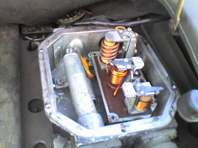

Took the cab off the Mog last week to replace the clutch. After putting everything back together again the bugger won't start[:(]
This little fella is the culprit...
There's power going into it but nothing coming out. Is this easily repairable or do I need to replace it?

Don't know about replacement, but be sure to check all of your ground connections if you had the cab off. When I got my mog, bad grounds were the cause of almost every electrical gremlin. Seth

That is a gen version of a voltage regulator. It should not have failed unless it is severly worn or corodded. If it is bad, I have at least one extra.

Check the AMP connector pins in the connector itself. Some times these work loose and don't make good contact when reconnecting. The ground issue is very important here as well. If it worked before the cab was off, I'm sure it's something that was over-looked.
