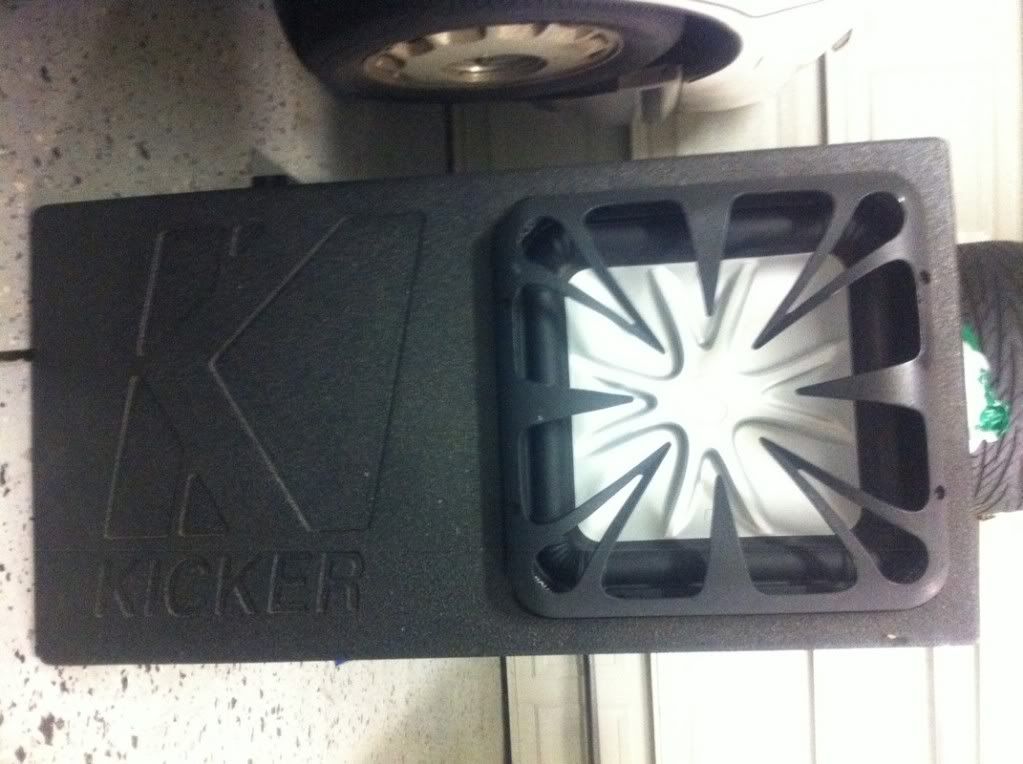

Sounds awesome. I disconnected the stock sub and installed single Kicker L5 12" Solo-Baric in Kicker enclosurer. A lot less rattle than I was expecting. Thanks for the tips in your write up saved me some time with the sub-rca hookup.
I'm glad I could help! I had the same exact Kicker setup that you have in my other car (just sold 2 days ago). What a coincidence! And yes, it sounded great when I had it! Enjoy the new set up!
Crappy Iphone pic of my old Kicker set up:
