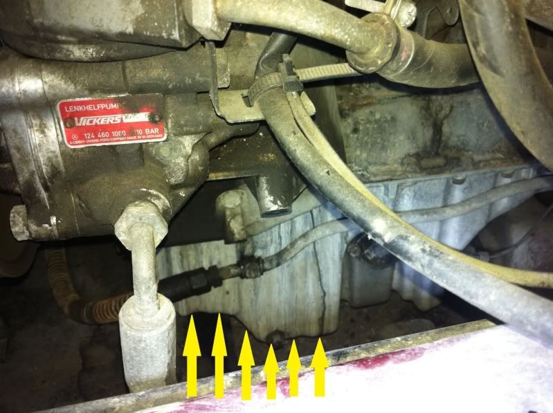

I've noticed that coolant has gone missing over the last week or so, about 300-400ml. The passenger side of the block is wet with oil (assuming timing cover leak), and the drivers side is dry. But I noticed a little tiny stream going down the side of the oil pan. I then noticed all the dried up coolant marks (from what I'm assuming is wind turbulence.). Its not yet making a puddle under the car, the leak isnt that bad yet.

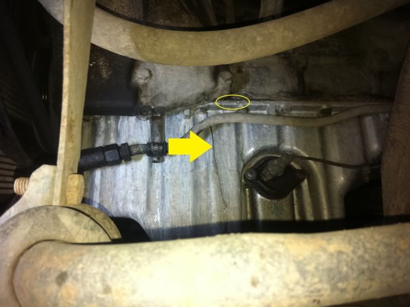

I examined the water pump while running and while off, used a mirror and can not see any water coming from it anywhere. Does the pump have a weep hole? Where is it located? The short hose connecting the pump to the head doesnt seem to be leaking, and i dont see anymore locations where it could be leaking from. When I follow up the little stream up the oil pan there is a little puddle where the block and pan joint (circled in the picture) and then runs to the front of the engine and hides behind the power steering bracket?
Water pump??
(1986 260e with the m103 with 202,000kms and zero previous history)

A quick google search and i see the water pump. I see there is an o-ring where it connects to the block. I guess it could be that. The I will have to look at it when the vehicle is here again.
Before I jump in and rip this pump out (from what i've been reading its a 8 hour job?) Anything else that it could be? Any coolant passages near that area where it could leak out the headgasket?

The bad news is that you still need to change the water pump when it's leaking. The symptoms you describe are exactly the scenario of what happens when the water pump leaks from the weep hole

Definitely the water pump leaking. Definitely.
I've replaced the pump several times (on several different cars) and the symptom is always the same: coolant loss followed by discovery of coolant trails or drips on the left side of the oil pan.
