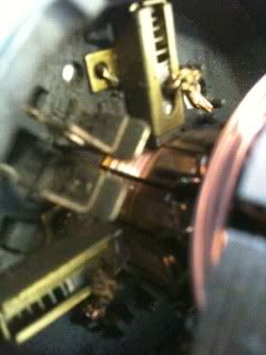

So I waited for the lights to come up, car warm, and then tried to manually get the ABS motor to run again by jumping the wires on relay K25. Now when the car is cold, I could hear the motor run, but this time, the car had run for 20 min, and the lights had come ON. Well, when I tried the ABS did not run this time. Once the car cooled down it started to run again. I checked the resitence at the ABS pump connector and everything was fine there.
My conclusion was that the ABS motor was acting up after it runs a few times. So I decided to pull apart the ABS motor and sure enough the brushes are almost gone.
It seems that since they were making very little contact, they would work fine when cold, but once the motor is turned a few times then they quit.
Now, I have a bad ABS pump. Since I don't want to spend $250 to rebuild it, I did some search online and found the perfect brush for the motor.
The brush that fits the motor should be 5mm by 5 mm and around 13 mm long. I found the right brush on a website called Carbonbrush out of California. The part number L5-5H and it should be material "Copper M" on their website. For only $15 and some patience I will have my ABS motor rebuilt.
And here are a few pictures to show the actual problem.
I don't know if there is a DIY on the ABS motor, but I think since this motor is so problematic on the ML there should be one.
Thanks again, and hope this helps someone.

When the brushes shown in the picture are completely gone, then you will get the three ETS ABS and ESP lights come on all the time.
Previously I had another ML320 and the three lights where coming as soon as I would start to drive off (within 5 seconds after I started to drive). That was easier to diagnose and had the same problem. The ABS motor was gone, brushes 100% gone.
This one was harder to find the problem since the brushes were "almost" gone, they were making minimal contact and thus will work ok sometimes usually when car was cold.
If I was you, and if I have this problem ever again, the first thing I would check is the ABS motor located right under the windshield washer fluid tank.
Take the washer fluid tank out. The ABS motor has only two screws that hold it in place. Take those off and pull it out. Test it by suppling 12V to it. Or even better pull the shaft out to check the brushes. As shown in the picture in my previous post. Mine would spin fine when the motor is cold, but after it warms up then it stops working thus my lights coming on.
I am waiting for the brushes to come so I can put everything back together. I will try to take a few pictures when I do that.

Most likely you wont have to bleed anything.
If you look at the pump that I am holding on my hand on the pictures, you will see the end of the shaft and a bearing on it. On the end of that shaft, there is a small cap, which is not shown in the picture because it stays inside the ABS unit. But if that cup comes out when you pull the pump out, then you will need to bleed the system after you put the cup back on.
Now the cup doesn't usually come out that easily but it is possible. When I usually pull the pump out, as soon as i remove the screws I pull the pump out very little. Just enough gap to be able to insert a flat screwdriver toward the shaft you see on the picture to ensure the cup doesn't come out. This may sound complicated but if you pull the pump out once you will see it is very easy.
I would just remove the screws and pull the pump out, if the screwdriver tip doesn't make sense. Just keep in mind there is a 5% chance that cup will come out and then you will have to do bleeding.

No. Yours seem to have some life left. Just to double check put 12V to the motor contacts, or with a Multimeter check for continuity (resistance). But it seems that your problem is not the motor itself.
It wasn't that bad to pull out was it?
This is the next thing I would check. Once you double check the motor, then put it back. Pull out the cable that goes to the ABS unit. Get a multimeter, test the resistance on the two bottom pins on the ABS unit. The two bottom ones are the ones that take power to the motor. And it seems that several member on the forum have had contacts that were loose. In case there is no current going through the two bottom contacts then your problem would be that part right there (the opposite side of the ABS motor you removed). You will have to pull out that part, open it up and solder the contacts on the back. I didn't have that problem but it is common as well. There is some instructions on this forum about that as well.
