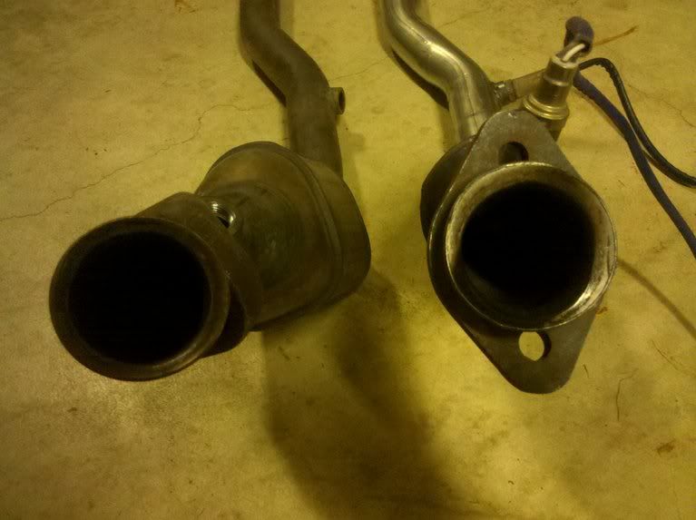

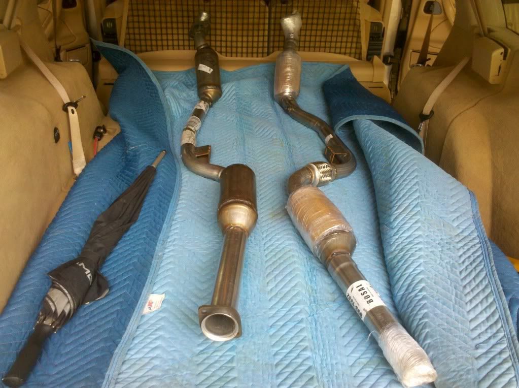

I ordered the drivers and passenger cat assemblies online for around 800 bucks shipped. The driver side fit fine and looked OK.
The passenger side was welded wrong. It was close when looking at the Merc part and the Bosal on the ground. When we got it in. The flange that goes to the exhaust manifold on the motor was off by about 20 degrees creating an exhaust leak. It would not seal up. The only way we could get it to seal 90 percent of the way was to not use the transmission bracket. This is unacceptable.
SO anyway, if you have the money to buy the oem parts. I bet they fit a whole lot better!
I will see what the guys I ordered from will now do. Hopefully just ship me out a new one and I can return the old one with a return slip.
No wagon for a while. I don't want to put the old ones back in. Just let it sit until I get a good one.
Attached are some photos of the cats. Notice how far off it is on the tranny bracket and how much space there is above the cat! More than a full snus can of clearance!
Needless to say, my friend who works on cars all day long was not stoked with the product. We spent 3 hours dicking around trying to make it work. He's a Mercedes Master Tech who works on this stuff everyday so it went in easy. The trouble started when we fired it up. It was ORC off and sounded like a race car.

After looking at it closer and really comparing the two, there are several errors throughout the assembly. The welds and materials look great but the bend is slightly off at about 20 degrees and short 3.25mm. The only way I could do it would be to cut it off at the pre cat, then bend it, weld it back on and then possibly still have to cut off and reassemble the tranny bracket.
I'd rather get the part done right. They will have to eat the shipping on all ends. My welding skills are not like the guys that do this 8 hours a day 5 days a week. Too many errors for me to correct without making it look like a fankenstein assembly.
This car is only used for road tours with the family and stress relief (fishing) for me. It can sit in the garage for a little while. I could just put the merc. cat back on the right side but I'm wondering about flow specs being different between the two. Probably not a big deal.
Either way, there is something to be said about Merc parts... They work and fit like a glove.
Would I go OEM if I could do it over again? Probably not at at the prices I have found. Sure wish the previous owner would have caught this under warranty. It would have been honorably discharged from the vehicle!

Ok, another update. I put the mercedes cat back in the passenger side since it was still good. The backpressure was actively tested and everything checks out good with one bosal on the L and merc on the R.
I sent the defective passenger side bosal cat back to parts geek. It cost me $71.00 to ship it with 400 dollars insurance and tracking.
The package came from Bosal directly in Indiana so PartsGeek is a drop ship company with no inventory. The bosal guy in colorado told me to contact them if partsgeek screws around with the refund. I have read stories that they will also charge me a 15% restocking fee. They better not with a defective product. I highly doubt they will offer to pay for the shipping back to them.
Here are some photos of the original and the bosal side by side lined up as close as possible on the ground. You can see the flange angle is off, the transmission bracket mount was the common point of alignment when I took the shot. The pipe is also ORC short at the end. You can see where the exhaust leak was in the photos.

Also, notice that the cats in this thread have 4 welds vs. the newer Bosal parts have 2. It appears that Bosal has overhauled their manufacturing.
