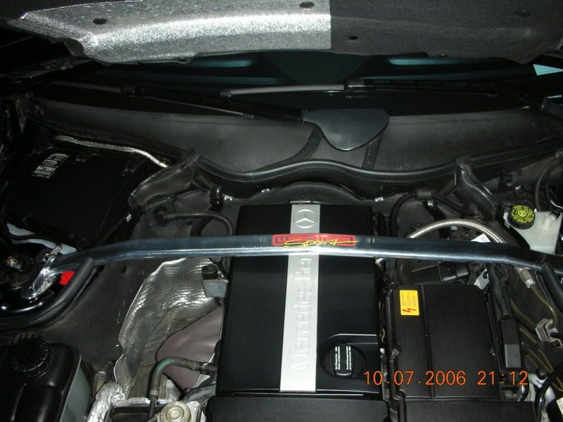

I've looked for a Strut bar but I had to mill my own brackets and use the bar from an Accord. Eibach makes a killer swaybar, I've only read good things about them and have ridden in a 2005 C sedan with them and it was great.

try auto-mark.comspookie said:rlee02135,
Does the site you've posted has a translation to it? All I got were in German or something. Your engine looks exactly like mine and I have a 2005 C230K SS, will that sway bar fit in a 2005? I've been looking for a sway bar for a very long time and was never able to find one. I've also looked at eibach and I don't see one for my car. Can anyone help me?
Spookie
