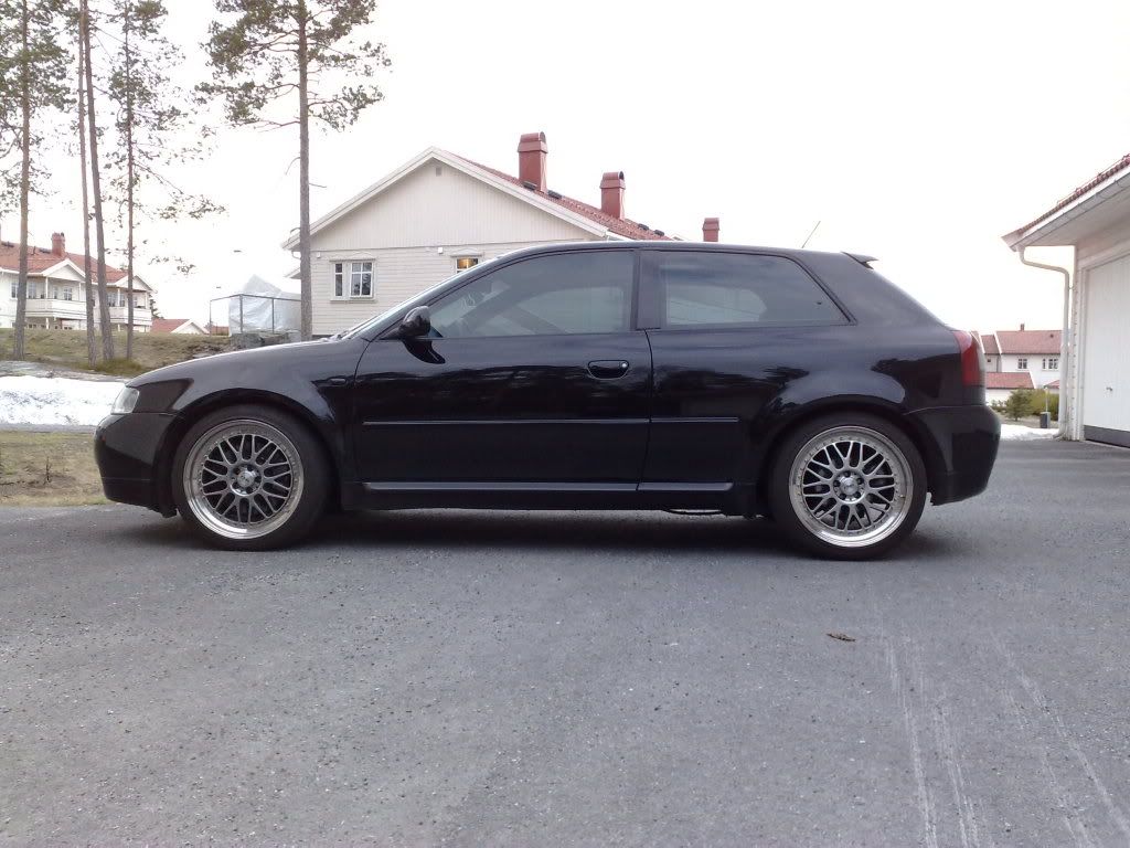

2001 Audi S3 8L (remapped to 270hp, Bilstein/HR, Dahlbäck Racing intake, Forge FMIC.. God I loved that little Pocket Rocket)

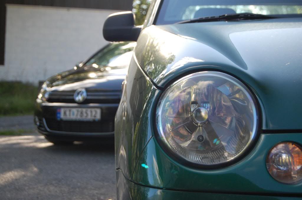

1999 VW Lupo (well bad picture and it was mostly the missus who drove it )
2003 VW Polo (mostly the missus who drove it )

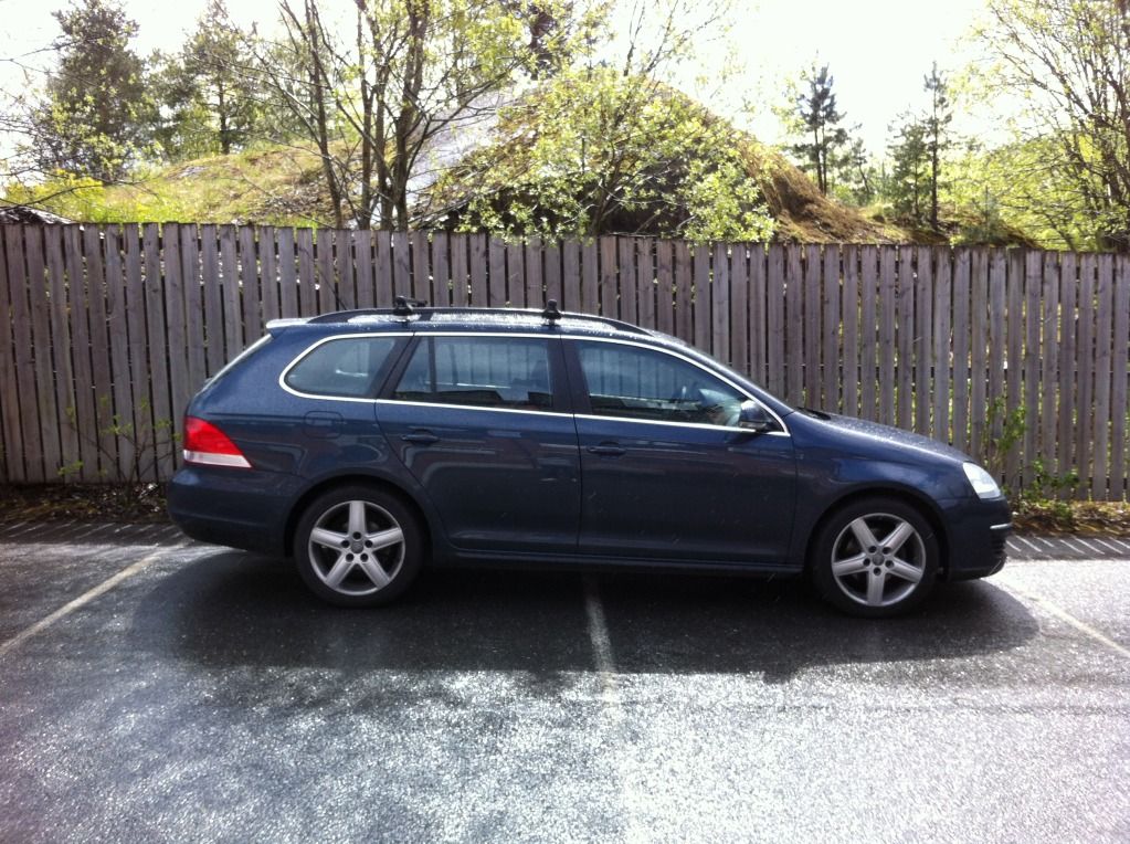

2010 VW Golf 2.0 TDI 4Motion (Eibach springs and wheels)
