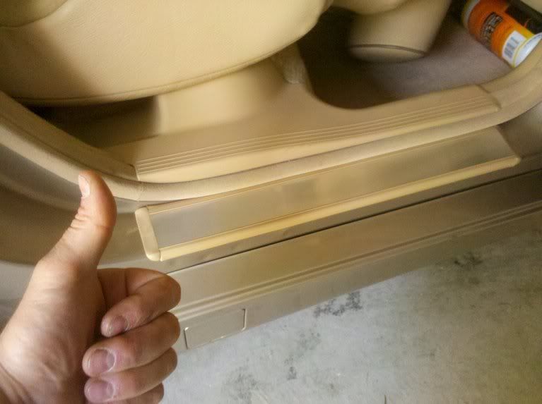

Carefully align the plate and look in the gap to see that the male parts of the clips line up with the female. I had to push the plate towards the car to get it in properly. You don't want to press them down at an angle. They need to go straight down.
Once you have them lined up press down over the top of where the clips are and they will seat in nice. Pat the plate down and you will hear them all click in with a distinct locking sound.
Now your door sill plates will stay in place and won't create corrosion. The big key is WAX! The Germans love that shit!
Good luck!
