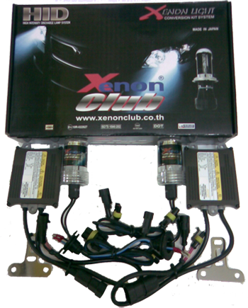

There is cheap HID kit that can be use with the original halogen head light.
But may be needed some modifying.
In Thailand there is a shop doing this.
??????? ?????????? ??????????????? ???????? *XENON* HID BY XENON CLUB
?????? (Customer) - ???????????? HID XENON BY XENON CLUB

Thanks for the reply, but I'm not into modifying. I just wanted a good price on headlights, and confirmation of the fact that the socket comes with the headlight assembly.
I don't like HID lights anyway; don't like being blinded by them so I won't do it to others.

HID has many advantages over Halogen type.
With proper adjustment will do no harm to other driver.
If you choose the original halogen again...the problem of heat and melting socket could happen if quality is not good enough.
By nature HID consume less wattage thus less heat generated while have more brightness than halogen.
HID is about 35 Watt and Halogen 55 Watt. HID help your battery or alternator will work lighter load compared to halogen.
However halogen bulb is cost much cheaper. But shorter bulb life than HID. HID life is 5 time longer.
If we put more wattage of halogen bulb to produce more brighness, this could melt the socket by the higher heat it generate.
So with original halogen headlight, use original wattage halogen only.
