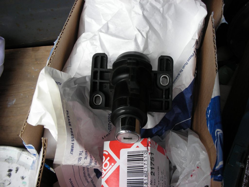

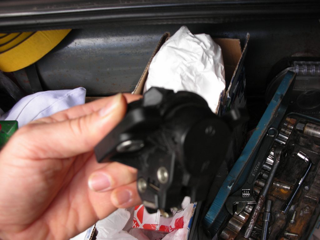

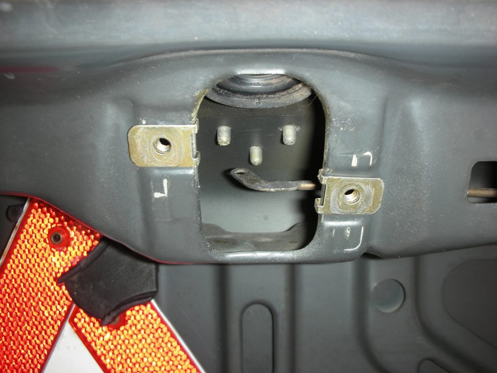

I'll post some pics:
The locker place, with the rod:
The locker that has no hole on the back cover, where to fit the rod.

If you look in Kyn's posting, part #20 has a cylindrical post on it for the lever; this post tends to break off. I went through 3 locks before I found one with the post still on it. It is easy to remove the part and fit onto your lock. It is also fairly easy to remove your lock cylinder to fit into another lock.
I will try to post a pic as soon as it stops raining.
