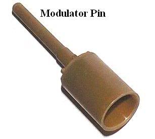

It is also a good Idea to replace the modulator Pin which is located behind the modulator after removal these are know to break.
