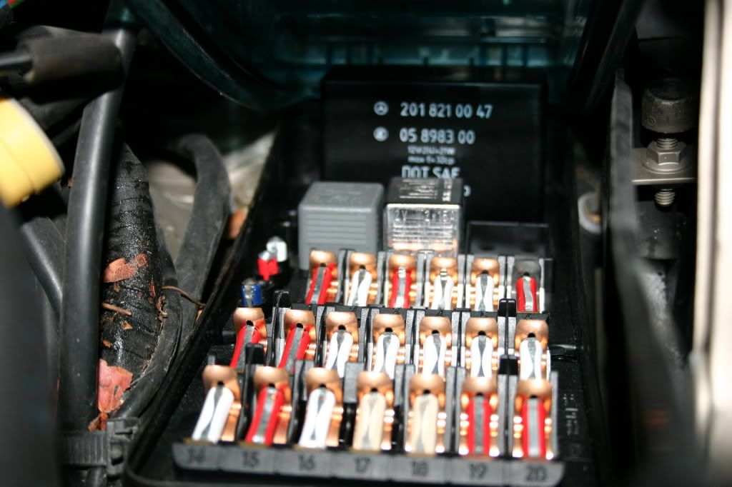

Alright I'm bringing it back. Earlier tonight someone mentioned the fusebox so I did the search and found the layout. I didn't realize that there was a relay that controled both the rear window defroster and the wipers. Because I've now realized that the car only acts up with BOTH of those things on. So now that I've already ordered the wiper motor and all that, does someone think there could be issues with that relay that could be screwy? Ill attach a picture of the fuse box, its a shitty picture from my phone, but tell me if you notice anything out of place or mysterious.
Also, what is the second picture for? It's in the trunk underneath the passenger side tail light

I'm not certain which off the top of my head but I'm pretty damn sure you should have some blue fuses.

I think so too, but Im not sure what voltage or amps each color is? what is white? what is red? what is blue? Because I changed them all to the exact same place as it was when I bought the car. So could someone pleast take a pic of the their fuse box?

Alright I answered my own question by browsing E-bay for a fuse kit.
White = 8 amp
Red = 16 amp
Blue = 25 amp

That's perfectly normal and is an indication of a good wiper motor. My C280 does that on wiper position 3 too. Don't bother buying a new wiper motor.
I think you might be on to something with that wiper relay, but first I'd check the alternator.
