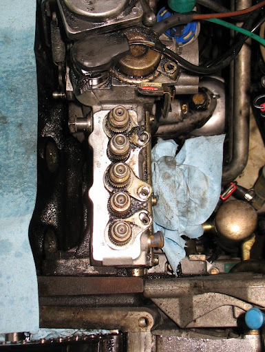

Where is the shut off at on the pump?

It's the round white or silver item right next to the ALDA, on top of the pump. If you don't already have one, you really should get a dual action vacuum/pressure MityVac for testing items like these.
The only reason for them to leak is if they're worn through, or the fittings aren't tight or are stripped.

You woundnt happen to have a picture of such item would you?

This appears to be a newer version of the one I have.
In case you were asking about the vacuum shut off pod...it should have a brown vacuum line connecting to it

Ok I see where the shut off is. Its under a can correct?
Is there any way to test the shut off?

Apply vacuum to the port and see if the shut off arm drops down. Release vacuum and see if it pops all the way back up
