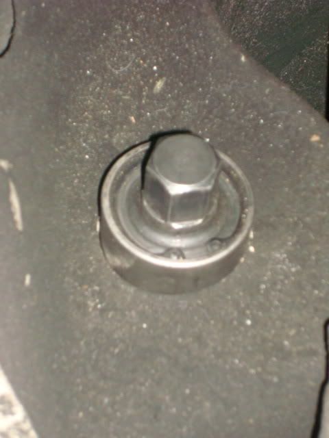

Well I am in the midts of tearing my front end apart to replace the upper control arms, lower ball joints & bushings, brake control arm bushings, tie-rod assemblies, etc-etc. So, I figured I'd compress the springs so I could work without the fear of having my face torn off when my jack fades :D.
I am working with the Baum spring compressor kit and I am a bit miffed as to the proper operation of this set. Let me preface this by saying that I called Baum customer support and they had no answers concerning usage on the W123.
Ok, so I inserted the two plates into the spring, and I dropped the compression rod though the holes in each plate. As I began tightening, I noticed that the rod doesn't make it all the way through the hole in the engine compartment. So I figured that I'd just have to compress the spring and leave it there -- do one side at a time. So I continued tightening and the spring kept compressing, and then THWAP!! I just about defecated, but quickly regained bowel control after realizing the spring was still neatly in place. Here's the odd part, the upper part of the compression rod that didn't fit though the hole before, now has slipped half way through, and is jammed. I figured that the metal deformed on the car and I was going to have an ugly egged out opening, but it didn't. It's almost as if the upper part of the tool changed diameter?? So, I backed off the nut in the top, released all the tension, and the tool is still jammed in the hole.
I have no idea what to do with this thing, and there are no instructions. I certainly do not want to damage the car, and I would prefer not to meet my maker over a coil spring.
Any help would be GREATLY appreciated!!!

Here's what happened:
Plan A involved me trying to get the tool back out, like "300Dman" described in his post above; I lowered the rod, adjusted it for removal, raised the rod & pulled the lower plate. Then I tried to free the rod with movement and pressure from beneath with a variety of tools -- to no avail. Problem was that the rod was very tightly wedged in the hole.
Plan B was to just get the rod all the way through to the other side with blunt force. Not wanting to foul the threads inside the rod, I opted not to simply wail on the adjustment nut itself. So I grabbed a socket large enough to miss the nut, but small enough to rim the rod (kinda like pressing in a bearing) and started smacking it with the dead blow. After about half a can of deep-creep and 10 or so good blows, it made it though. Strangely enough, there is no visible damage to the opening at all!
Here's the crappy part, I assumed if I could get it thought the hole one time, it would open up slightly and be more willing to go back thought it a second time when I reinstall the spring, like sizing a ring. Not the case!! So I imagine I have to either enlarge the opening about a millimeter, or find another tool. This kit states it's for the W123 (among others) but unless it's defective, the design is a bit thoughtless.
Thanks again everybody for your help!! Let me know if anyone is interested in hearing about and/or seeing any other aspects of my steering, suspension & brake renovation. Perhaps I could be of assistance too!
