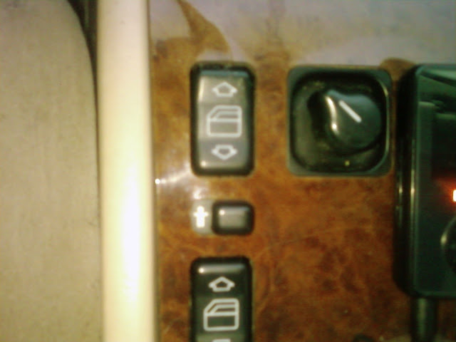

I had a 93 400E with ASR (has the same V8 4.2 liter engine. Ignition cap n rotor. Yours probably has coil packs). Fortunately, I didn't have any problems with it at 160k miles. Though rewired the 1st gear over ride to the rear window's lock out switch. (since it defaults to 2nd at stops). Also gives you an extra kickdown gear on the fly. * Not recommended over 50 mph *.
A minor upgrade thanks to 2Phast's W124 site.
